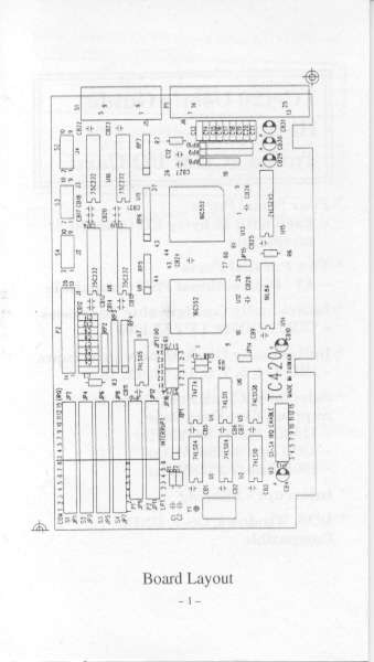

I searched for about an hour with TC420 and statson images, then I looked at the back of the card
“Byte Runner FC-420”
Manual is here
