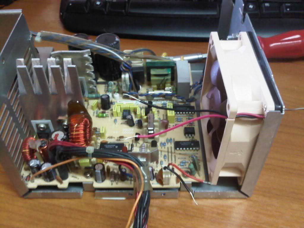

Reply 140 of 472, by TELVM
Well done and nice touches with the fan header and resistor. respect-048.gif
Just in case, after tinkering with a PSU always first test it outside of comp, with paper clip and a couple old fans attached for load. This will minimize collateral damage if something goes kaboom. lol-027.gif
Let the air flow!
Reply 141 of 472, by keropi
thanks!
the resistor was needed unfortunately, the "silent" fans were only silent in paper... don't know how much the fan will hold until it groans but for now it'll do 😀

Just curious, what fan did you end up using? I've thought of sourcing old 5V-heavy power supplies, replacing their capacitors and possibly their fans too. You frequently see people buying ADDA, Delta or SUNON fans on other forums. Is such an extreme measure necessary?

There are people who fit a Noctua NF-F12 inside a CX430, but IMHO for retrocomps up to PIII systems, that probably will never draw even 100W DC and will only see occasional use, any quiet, unexpensive fresh fan will be enough to handle the little heat generated inside the PSU at such lower draws. (Provided there is decent case ventilation and we don't burden the poor PSU fan with full responsability for cooling the entire PC, that is).

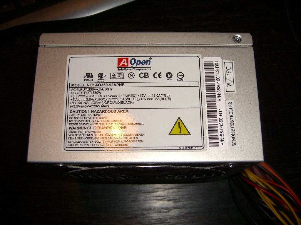

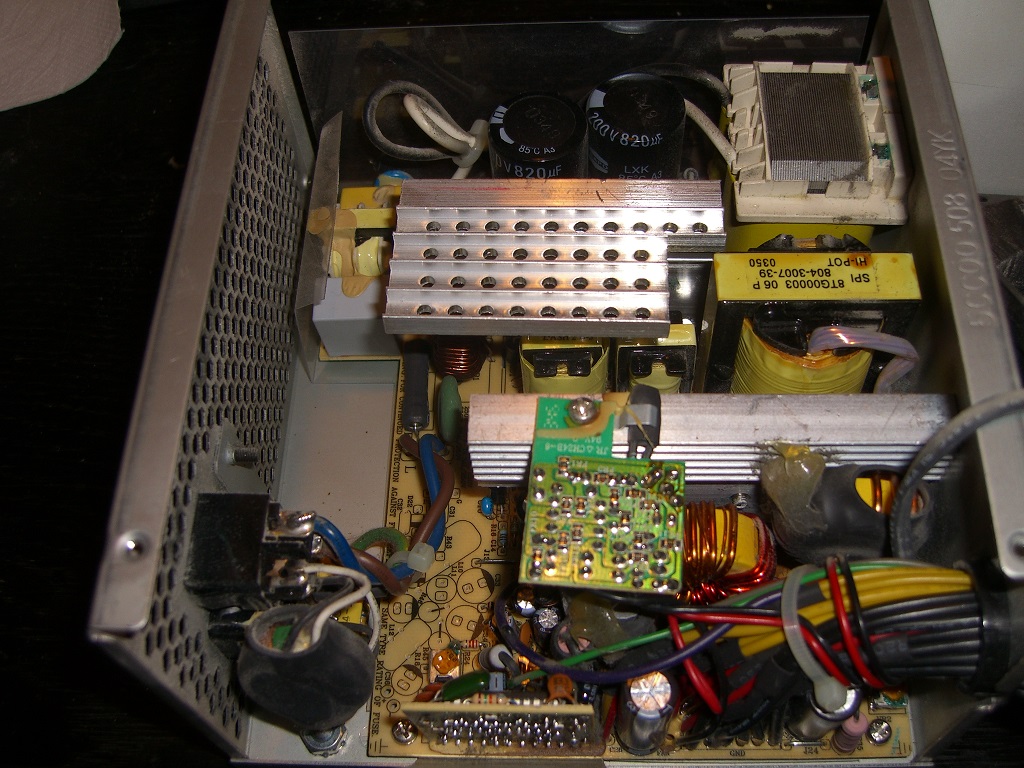

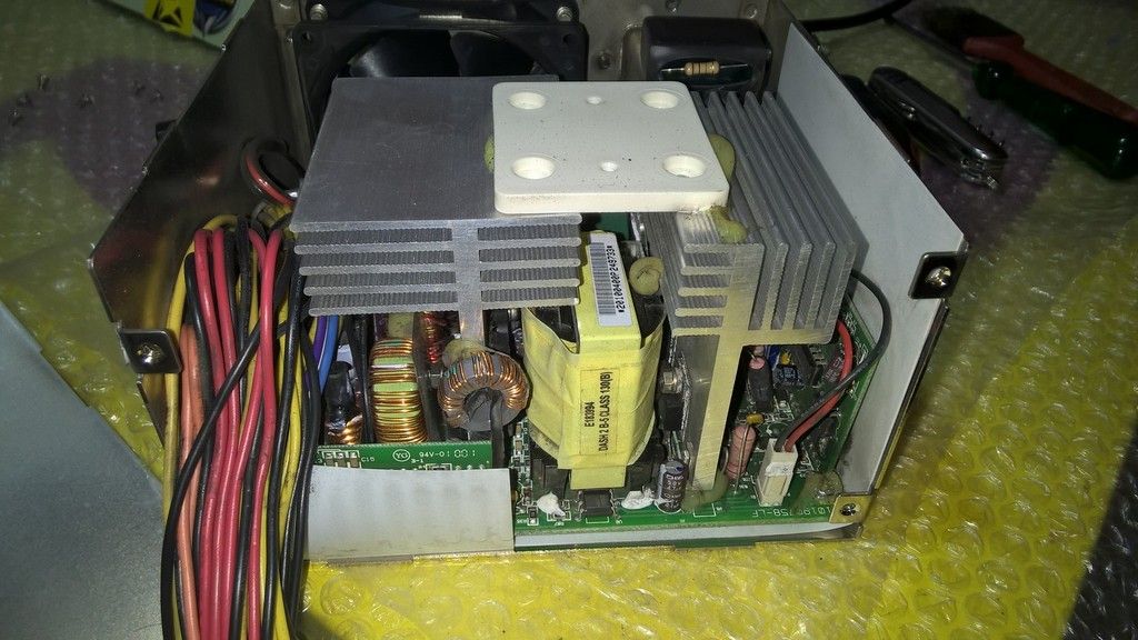

I want to use this old AOpen PSU with a Pentium 3 system as it has a 120mm fan that will help with the cooling of a otherwise poorly ventilated case.
The spec.
The inside.

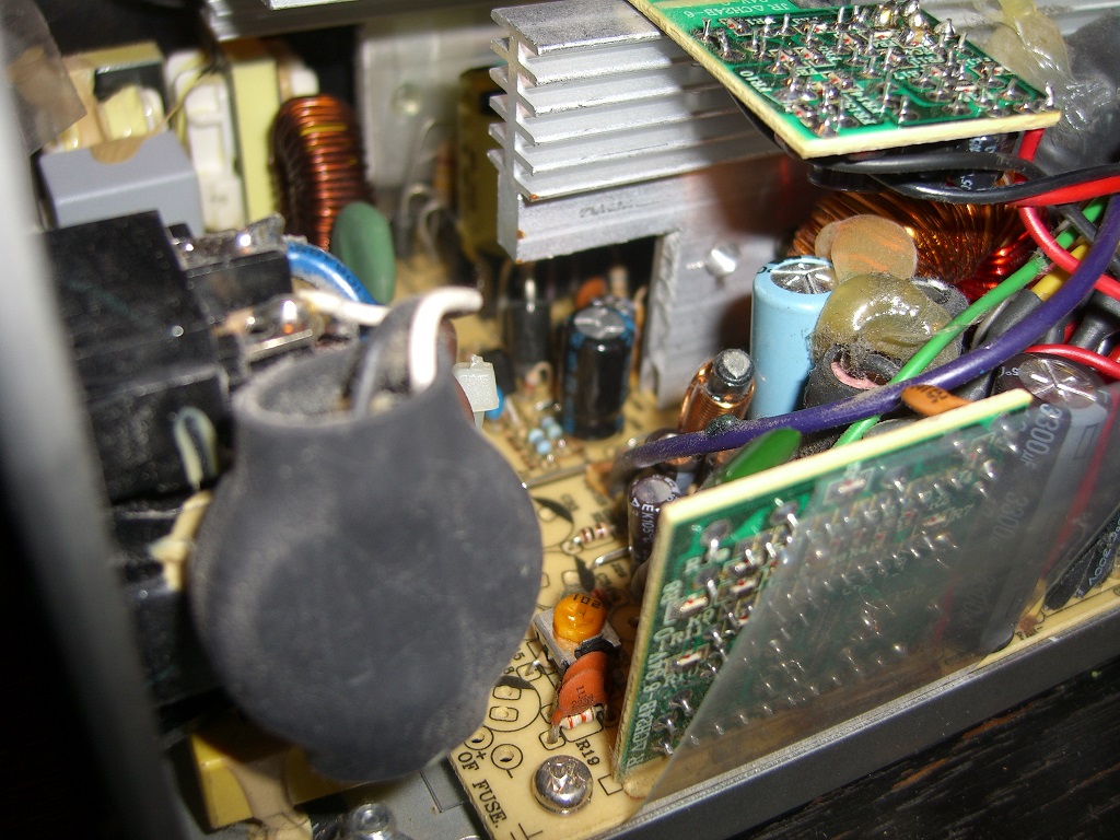

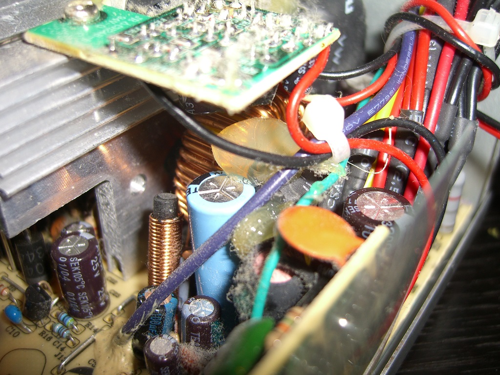

The suspect. This blue cap looks a bit suspicious, not leaking but slightly bulged. Does anyone know what this cap is supposed to do?

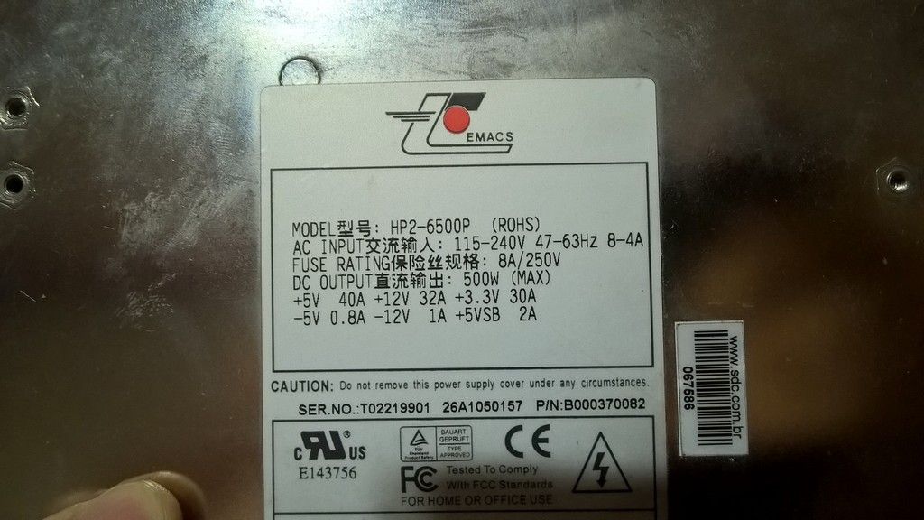

Just grabbed two of those:
Never saw a cramped PSU like this one before.
It came with a funny connector (yes, it has the same keying of a PCI-e 6pin):

Reply 152 of 472, by TELVM
Skyscraper wrote:
... This blue cap looks a bit suspicious, not leaking but slightly bulged. Does anyone know what this cap is supposed to do? ...
Can't see much but that light blue Teapo cap is close to the +5VSB wire (purple), it might be for +5VSB output filtering. And it's clearly bulging up.
Snayperskaya wrote:
Any thoughts?
Looks cramped because of the huge, thick, efficient heatsinks. Again can't see much but from a distance it screams quality, as the jap caps confirm.
Found a review, it's an excellent +5V super-heavy PSU originally designed for servers, ideal for powerful +5V heavy retrocomps.

Reply 153 of 472, by Snayperskaya
My bet is that those two were pulled from servers. Also got two hp2-6400p (the 400W version of this) a month ago. Put one of the 400W ones on a modern, low-power system (AII X4) for my parents. Got them for ~17 USD the 400W apiece and ~27 USD the 500W ones. Pretty good value for server parts (that usually last forever).
Reply 154 of 472, by Skyscraper
TELVM wrote:
The +5VSB rail seems to perform OK, the only rail that is out of spec is the -12V rail, it hovers around -11.5V and I had to turn of the CUSL2-Cs monitoring of this rail or it would nag.
I tested the PSU with a P3 1400@1575 and a Geforce 6800GT and it at least worked. All other caps in the PSU look good and all important rails perform fine if my DMM is reading things right. This system wont see much use so I think it can live with this PSU for now.
Reply 155 of 472, by wave
Using a psu with bulging caps is a terrible idea!
Reply 156 of 472, by Skyscraper
Not only using, Im pushing a Tualatin 1400-S @1680MHz through some benchmarks with a Geforce 6800GT 😉
This system probably wont get used at all beyond these benchmarks as I have another CUSL2 system also with a Tualatin 1400-S that I do use. I just wanted to run some benchmarks in XP while testing out the new spare hardware I bought. Systems I use frequently have better PSUs... at least most of them...

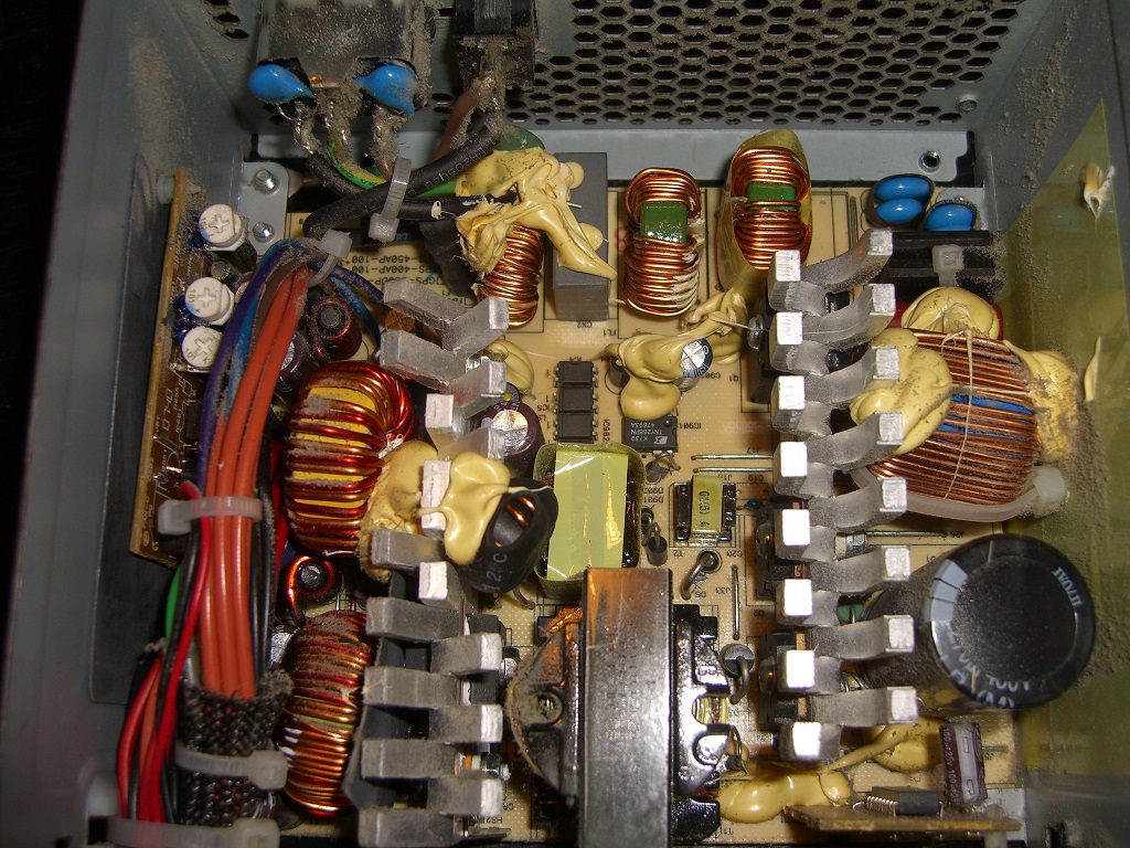

To make member wave sleep better at night here is a pic of the inside of the very similar AOpen 300W PSU I do use with my P3 Windows 98 system 😁. The inside of this PSU looks exactly like the 350W version above and the rails max amps are the same only maxium load and max combined load on 3.3V + 5V differs. Well the blue cap also looks a bit different.

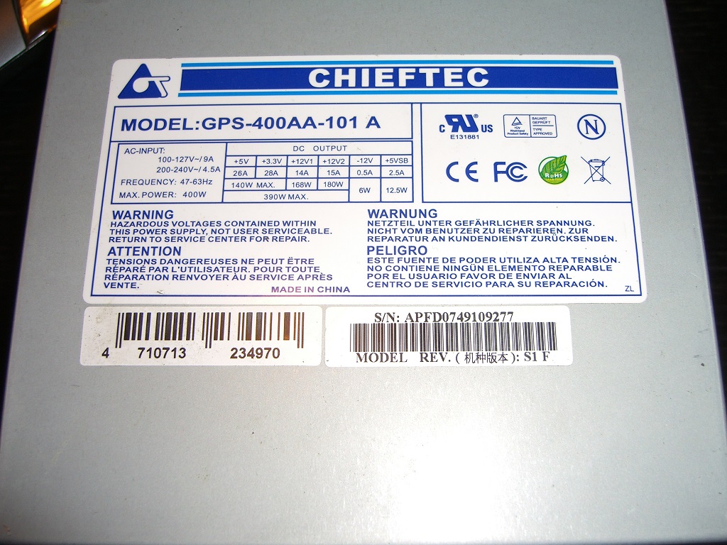

What do we think about this old Chieftec PSU? It dosnt have any bulging or leaking caps.

Reply 159 of 472, by wave
GPS-400AA
That's a Delta 😀 😀 😀 😀 😀 😎 😎 😎 😁
Delta is in the top 5 of best power supply manufacturers. Definitely worth recapping and keeping!
