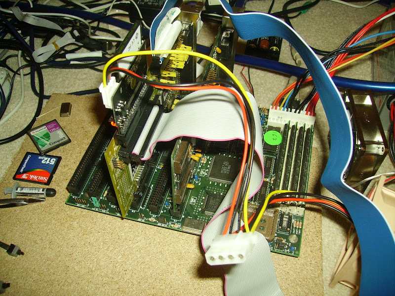

I just received this interesting looking 386 mobo [see my original post], and it works! It even runs Windows 95. I removed the 4x 256Kb (1MB) SIMMs, and installed 4x 4MB (16MB) SIMMs. The evil barrel battery has got a tiny amount of "green death" seeping out of it, but none has touched the mobo yet. I am using a 3x AA external battery pack.

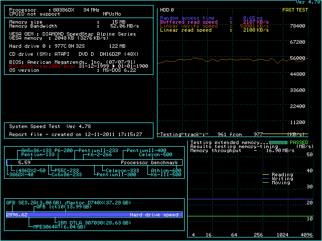

The mobo itself is so small. It measures 8.5 inches by 6.5. There is no external cache on the mobo. I wish I could find a chip to go in to that brown socket on the bottom right. That might give the board a boost. 3DBench gives me 9.7, using a Diamond Speedstar64 with 2MB of RAM. When I look closely at the image on 3DBench, I can see faint grey vertical lines. Is that normal?
WinTune97. Ignore the first line and notes. That was for another 386.
Speedsys
Reply 21 of 38, by Old Thrashbarg
That's a socket for a 387SX, and unless you're running ancient CAD programs or something, it will do nothing to boost the machine's performance. In fact, it will generally do nothing at all except sit there and get a little warm.
Reply 22 of 38, by Mau1wurf1977
That's ~ 386DX-25, which is very useful for games from the early 90s.

Reply 26 of 38, by TheLazy1
I see you have the same evil CF->IDE adapter I have, good luck disconnecting the floppy power cable. 😀
Reply 27 of 38, by retro games 100
After disconnecting and reconnecting it literally hundreds of times because of lots of testing, it can now be disconnected almost effortlessly.
Reply 28 of 38, by Markk
You can find one here : http://cgi.ebay.com/ws/eBayISAPI.dll?ViewItem … e=STRK:MEWAX:IT . But I really doubt that it would give it any boost... 😈

Not even in benchmarking?
Reply 30 of 38, by Markk
Well, I have experience with my 286/16 and my 386/40 PCs that both have fpus. If you run a benchmark that is capable of measuring fpu speed, yes it is the only thing that will seem different when running that. Using any other program, there is no speed increase at all. I guess it would be different if you had to run any CAD programs that could use such a chip. Now, since I had the fpus in my collection, I chose to place them on the boards, as I like to see the sockets filled... 😀
