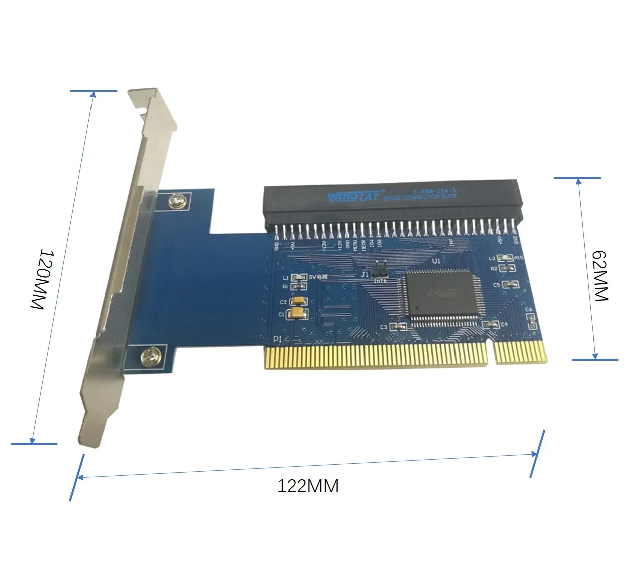

Theres some PCI to 8 Bit ISA adaters on aliexpress. Not sure the last intel chipset that supported PCI/ISA bridges tho. Could work with a riser + Ribbon. Probs ICH5
I doubt any of those would support ISA DMA without some kind of modification (if at all possible). They could be a nice way to add OPL2 or OPL3 to a board without ISA slots, however .
EDIT: Then again, a YMF7x4 based PCI card would probably be a simpler option .
Reply 24 of 28, by LightStruk
There's a really strong chance that these adapters won't support ISA-style DMA. If they're cheap, it wouldn't hurt to try, but just keep that in mind.
