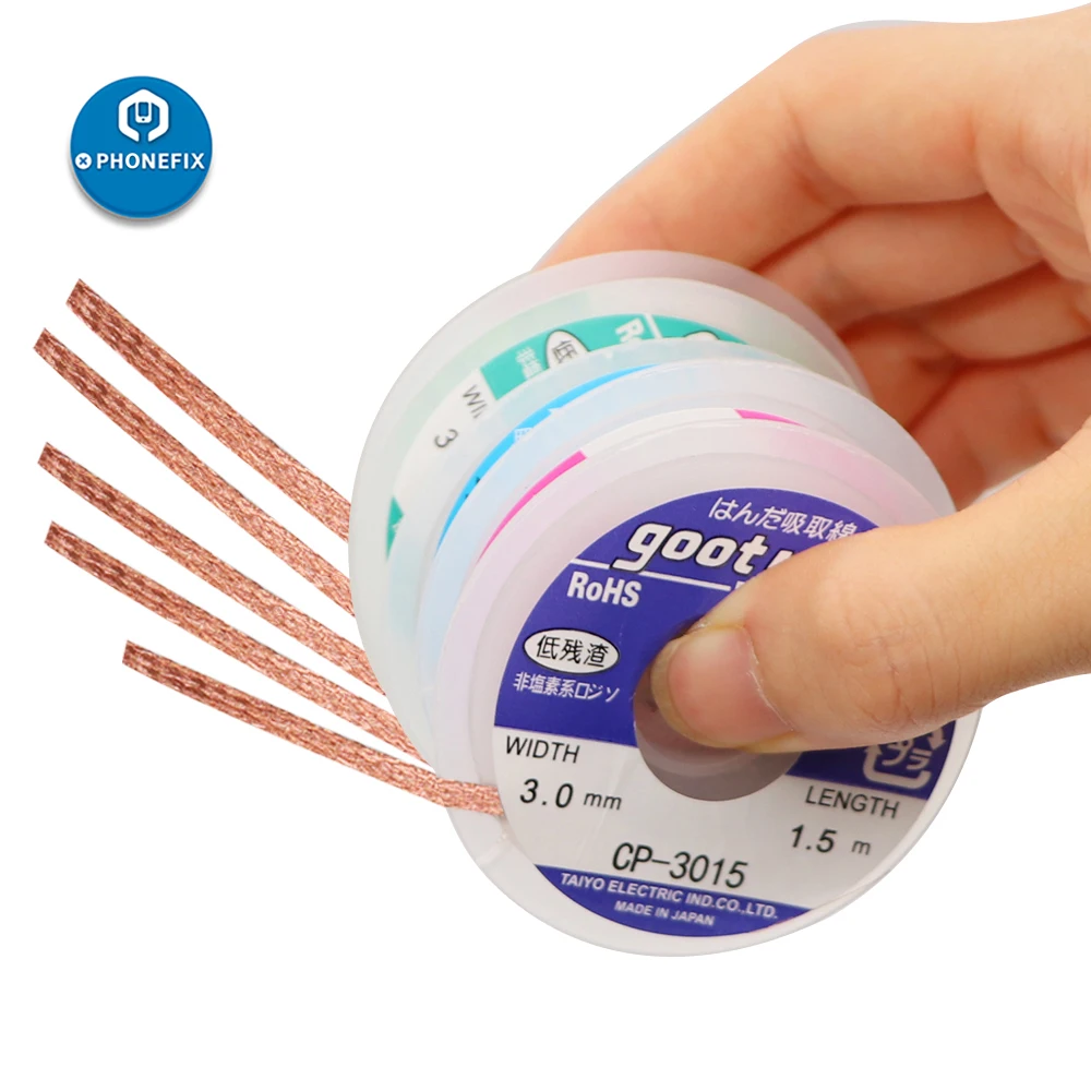

How do you remove solder from the pin hole? I have removed it everywhere, but on 2 pins. I add more soldering wire and then I use copper to remove it. But somehow, on 2 pins it's stuck and can't remove the port because of it.
i have a manual solder sucker and i have solder wick...
first remove large amounts with the sucker and then wick it clean to not waste more then neccesary...
5-st-cke-Goot-Docht-Solder-Docht-Entferner-BGA-Abl-tgeflecht-Draht-Sucker-L-ten-Zubeh.jpg
FCKGW-RHQQ2

I tried with wick and that sucker, but there is still some left. Maybe if I cut pins it will be easier
with 375c you have instantly burnt away all the flux from the flux core. if the solder desnt flow like it should add flux.
And ground holes are especially hard to clean because the large copper surfaces take away all the heat. that is the point where the thermal mass of your iron gets important... transfer all the heat inside the board and not just burn the surface in the beginning and then cool down so much it cant melt the solder anymore...
