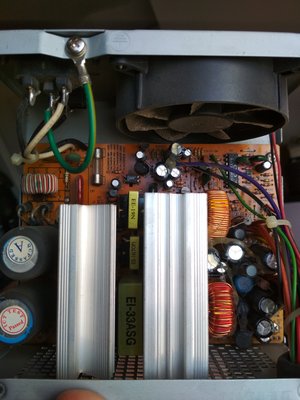

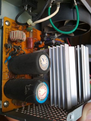

I opened up the PSU of the AT Tower I received for two weeks.
1 cap bulging, 2 have blown/vented alot. I am in dire need of some AT PSU's for my rebuilds.
My question, is this AT PSU worth salvaging by replacing the caps or not?
1.82 MiB
1437 views
AT PSU Internals1
1.84 MiB
1437 views
AT PSU Internals2
1.67 MiB
1437 views
AT PSU Internals3
1.74 MiB
1437 views
AT PSU Internals4
1.65 MiB
1437 views
AT PSU Internals5
Sorry for the Potato pictures, I hope they still are clear enough to see the important pieces.
Reply 405 of 472, by Ozzuneoj
I'm certainly not an expert on power supplies, but bulging or leaking aluminum electrolytic caps are fairly uncommon on devices made before 1999 or so... I've only seen them on a few very very low end Micronics SS7 AT boards. Anything with visibly defective caps before they were common may have been built with especially cheap components all around. I wouldn't bother with it.
Reply 406 of 472, by DAVE86
It's '90 generic at best. Has some EMI input filtering, though not all components are the safety approved type. Has a bridge rectifier, small input capacitors and the primary transistors are plastic to-220 types. Main transformer looks like EI33 size. Good enough for 200-230W depending on the switching frequency that KA7500 is configured to.
Secondary protections are most likely handled by that other chip which is a dual comparator.
The secondary heatsink is a bit flimsy. That two 3 amp diodes bunched together are the rectifiers for the 12V rail. It might not be an issue if the 12V rail is specified 4-6 amps max. The 5V rectifier looks decent, probably 20-30 amp rated.
If you have the time and spare parts/know-how you can try to revive and even beef the unit up a bit. Othervise don't bother with it.
Reply 407 of 472, by Nvm1
Okay so for a 486 VLB or a Socket 5/7 system with nothing special in it it can be used.
Changing caps should be easy, recapped alot of newer units where space is really cramped.
Other things I can improve outside replacing the old Fan and the old caps?

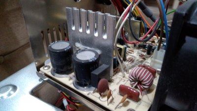

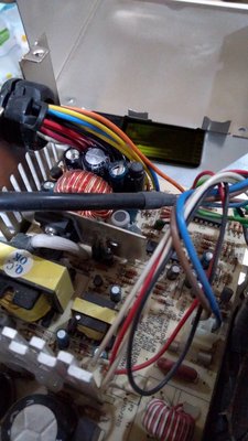

Reply 410 of 472, by okenido
Hi folks
Found this PSU, its working and quite clean, i was wondering if it's worth keeping and recapping ? Would be for some PIII setup.

Reply 412 of 472, by Ozzuneoj
If it's working, passes basic PSU tests and doesn't having swollen or leaking caps, I wouldn't bother recapping it. You're more likely to introduce problems to a working unit unless you recap boards all the time and are very experienced. It'd also depend on the brand of caps. If they're a decent name brand, they may last years without causing any problems.

Reply 413 of 472, by okenido
There seems to be two brands of caps, one labelled "DON" and one with some 'Y' logo in a circle.
I can solder easliy on the simple PSU pcb's, I was thinking about recapping since i've had some issues recently with old hardware - Randomly failed IDE drive detection, motherboards and GPUs that worked before and stopped working for no reason... I was using random PSU from my spare, they all work but some have bulging caps, I'm afraid it will kill my hardware even if caps look OK (their capacity decrease over time)

Reply 414 of 472, by gdjacobs
You should be able to find a ~250W ATX PSU from an OEM unit that's as or more powerful than this one (in reality) with proper component selection, construction, and circuit protection. This guy is probably a two transistor standby PSU that's ticking away waiting to go *boom* all over your retro parts.
Reply 415 of 472, by okenido
Do you mean the transistors in this PSU may fail prematurely despite the new caps ?
I also have two Delta OEM power supplies (200W but it says the total output can't exceed 110w), they are a bit newer than the FGI since it has a SATA connector
Reply 416 of 472, by gdjacobs
The Delta probably has a 110w limit on the 5V and 3.3V rails combined. This would be fine for a basic P3 without a huge stack of drives or peripherals.
The biggest problem will be if the transistors don't fail. An out of control PSU can potentially deliver huge amounts of energy to your components in the form of voltage in excess of breakdown levels or high current in the event of a short on the motherboard, for instance. One of the most important functions of a power supply is to gracefully shut down in the event of such abnormal operation.
A two transistor standby circuit is ultimately one of the cheapest ways of implementing 5V SB. The problem is that two transistor standby circuits are not robust at all, often featuring little or no protection. Hell, switching control can even be generated via an LC tank circuit, a Zener reference, and a handful of other generic caps and resisters from the Shenzhen market.

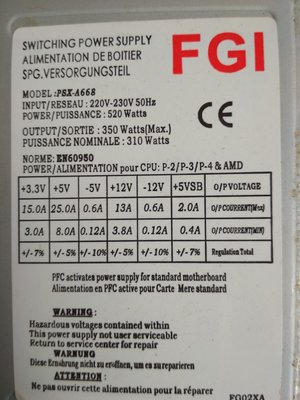

The PSU label

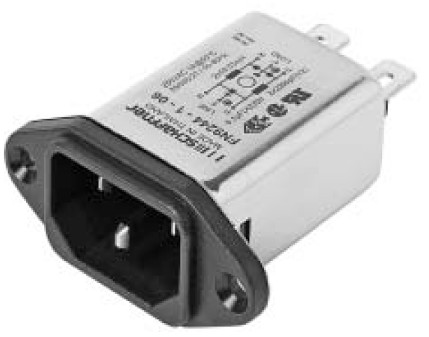

No Schaffer filter can, as usual. Will have to order one.

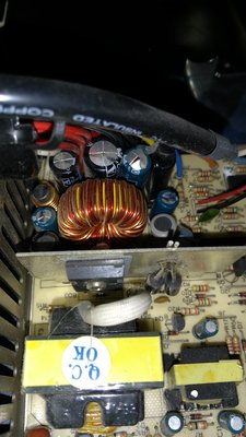

Lots of colophonium drip residues on the components side, which remained at factory cleaning. Removed because they have the potential of becoming conductive.
This confuses me a bit. Do diodes work better when well-heated by cramping under that coil?
Another strange view.
D11 and transformer battling for space, with the latter having to retreat a little bit.
D14 as heater to bring C17 to boiling temperature?

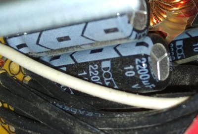

Anyway, 12V have 2000uF, 5V has 2200uF, didn't look at values for -5V and -12V.
All outputs, even the negative ones, seem to have pi coils.

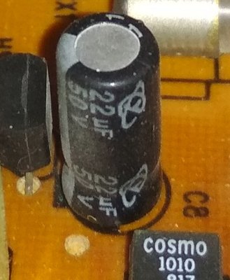

Caps rated 105C and have a logo "CTC".
There are two chips, one LM339N and KA7500B (?).
Mounted at the secondary cooler are BYQ28X 100 (I guess some kind of transistor?) and NDS40-30 (dual diode).
The two primary cans have 470uF and are Japanese brand. However, they are rated 85C only.
Rectifier is big block mounted in good height above PCB. Couldn't read full type, obscured by caps.
Switching transistors are NT2625N.

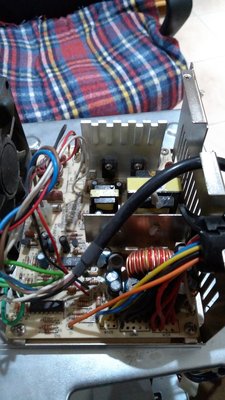

PCB solder side looks acceptable to me, just cleaned dust and colophonium residues.
As I prefer optimal cooling, I connected the replacement fan directly to 12V, not using the fan thermo controller circuit.
(I remember having read somewhere this would be bad - is this true? If so, for which reasons?)
