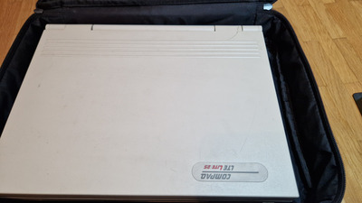

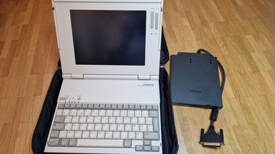

As I already mentioned here, I was recently given a Compaq LTE Lite 25 laptop in a reasonably good shape - just a few cracks on one hinge.
Initially I thought the power brick was dead, but after changing the cable the green led finally lights steady.
The attachment 20240418_221611.jpg is no longer available
After connecting the power to the laptop, even the battery light came on, indicating that it was charging... But I quickly removed it because I do not really want to charge a 30+ years old NiMH battery.
The attachment 20240418_222232.jpg is no longer available
Now unfortunately despite those encouraging signs of life, nothing happens when I trigger the power button. The computer seems dead.
The attachment 20240418_222236.jpg is no longer available
I don't really know where to start with the troubleshooting, any idea? I am assuming this computer can boot even in the absence of a battery, is this correct (anyway I tried even with the battery plugged-in and it does not change anything).

The 386 model can not power up if the RTC battery is dead. To change that you'll need to take it apart and pull out the systemboard which is in a big aluminium shell.
The top case comes off and upwards by prying some plastic clips around the sides and maybe some screws in back? Not sure, mines in storage right now. It's not easy to do but if you use a plastic pry tool / guitar pick around the seam from the side and pushing upwards the clips should release.
i80386sx is the expert on these - check out his channel: https://www.youtube.com/@i80386sx/videos
And specifically this video: https://www.youtube.com/watch?v=hL2myu5qjXQ
Once you've got the top case off then make sure to gently remove the flex cables as they are basically irreplaceable.
Once the keyboard and hard drive and screen are out / off then you can pull the motherboard's aluminium shell out of the lower plastic case.
Since it's the 386 model and not the 486, it's more likely that just the RTC battery being dead is stopping the computer from working. Replacing that should allow the laptop to work again.
Personally I ran wires for the RTC battery with a CR2032 cell holder into the expansion bay so I can replace it / take it out for storage without having to disassemble the machine anymore.
Check whether there's a NIMH cell inside the motherboard shell since that destroyed my 486 'LTE Lite 4/25E' motherboard. I'm not sure the 386 models are so at risk from that, you might be lucky.

Ok so thanks to this excellent video from i80386sx I was able to bring that little machine back to life !!
