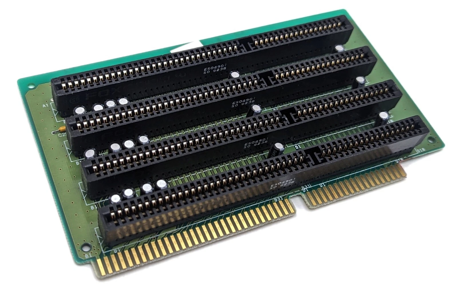

It is very possible that a standard 2 x 16 bit riser will work but would need to check the riser socket pinout...there are none on ebay I can find at this time....but there is 4 slot ones which could be cut down
https://i.ebayimg.com/images/g/HGMAAOSw9MRmA4-q/s-l1600.webp

You do not understand what we have been hinting at. We know your has two 31 pin "8bit" sections of socket. The one closest to back of the case would be the standard 8bit A and B 31 pin part. The other is split looking at that riser picture with the C and D 18pin part to the 16 bit section (standard method), the other C and D 13 pins going to a header. I bet a standard ISA riser would work inserted toward the back of the case.
I would use an ohmmeter and check the boards slot for PSU lines and ground to the red line from the back and see if it matches, it is does then should be no issue trying a standard riser.
https://en.wikipedia.org/wiki/Industry_Standard_Architecture or https://old.pinouts.ru/Slots/ISA_pinout.shtml

Oh, now I understand! Sorry, I thought the riser couldn't be shorter than a 16 bit. I don't know what the header is for, the 5.25 is on the back of the case and is connected with an IDE cable to the floppy header not to that. I'm gonna search for a standard riser with two slots and see what I can do. Thanks!
