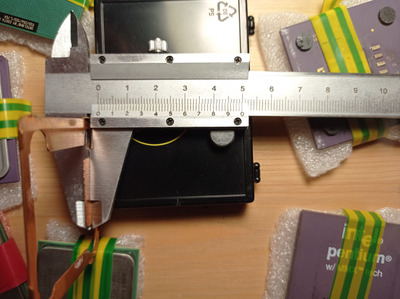

Do you have a caliper that you'd be able to measure the thickness? I'd like to get a board and try a 3D printed version, though I wonder if there'd be enough interest to put in a order with SendCutSend or similar.

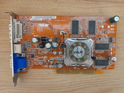

Reply 48223 of 57170, by RetroPC_King
Today I got for cheap a ASUS A9550GE/TD/128M/A AGP8X video card, a ATI Radeon 9550 128MB, with active cooling. I wonder if it is the 128bit version.
Any opinions?

Reply 48225 of 57170, by ChrisK
RetroPC_King wrote on 2023-02-27, 12:56:
Any opinions?
Should be 128 Bit since it has 8 x16 memory chips.
I have a 9550 (no-name), too, but haven't done very much with it yet. What I can say is that it is a bit slower than a Ti4200 in 3DMark 99 and 2000 when benched with an Athlon XP 2000+

Reply 48227 of 57170, by acl
Asininity wrote on 2023-02-27, 12:52:
I do, and i'm working from home today...
The attachment mesure.jpg is no longer available
I'm reading 0.65mm (can someone confirm ?)
Plus several CPUs
The attachment duron800.jpg is no longer available
The attachment Athlon1000.jpg is no longer available
The attachment XP1600.jpg is no longer available
The attachment XP3000.jpg is no longer available
No pictures from the side, but from what i see, the die is always slightly above the shim.

Reply 48231 of 57170, by ChrisK
acl wrote on 2023-02-27, 13:42:
I do, and i'm working from home today... […]
0.65 mm confirmed!
Yes, P III and Athlons have the same overall size.
What I can add:
Athlon XPs from Palomino up to Barton (Model 6, 8, 10) are spec'ed with a die height of 0.80-0.88mm. The original pads are 1.90mm max.
For P-III in FC-PGA package the die height is spec'ed at 0.787-0.889 mm.
So both almost match.
I'd say something with 1.00 to 1.10 mm made in TPU should be a good starting point.

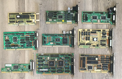

I visited the "Retro Computer Sale" which took place at the Centre for Computing History this Sunday (26-Feb-2023) in Cambridge. That's Cambridge, England BTW!
It's a small museum which has quite a number of exhibits relating to computer history in the UK. It is also "hands on" in that you can play games on a large range of home computers from the 1980's and consoles too. They hold events every now and again. Some years ago I attended a BBC Micro/Acorn Atom get together. Parking is limited. The museum is quite well hidden on a small industrial estate so it is easy to miss. Nevertheless Cambridge is a bit of a tourist hot spot in the UK, so if you are passing through you might want to plan a couple of hours for a visit. http://www.computinghistory.org.uk/. Entry was £10, the normal museum fee.
The area for sellers was quite small, but there was an impressive amount of retro stuff for sale, and prices were low. No Ebay prices here!
I was looking for old ISA cards and there were at least four sellers of old PC cards. More or less a quid each (I overpaid for the first 2 cards 😀 ).
The attachment ISA sound and video.JPG is no longer available
The attachment ISA IO and floppy.JPG is no longer available

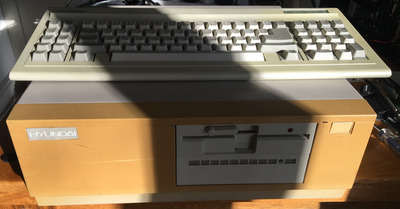

Finally I bought a PC, again for £50. I didn't even look in the box. Came with an XT keyboard (DIN plug) which I really needed. I was alerted to what was in the unmarked box on the floor by a interested buyer, who only had £10 in cash on him. When he walked away I bought it. When I got it home I was surprised to see that it had a MFM hard disk, 384k plus I/O expansion card, original floppies and documentation (but was missing the MSDOS disk) and a VGA card. I discovered it was/is a Hyundai Super 16 8088. Interestingly the layout of my motherboard differs from those I have found online. HDD might be faulty. I have no 360k DOS boot disk. Interestingly the BIOS appears to be some hacked version to give compatibility with "CUB" monitors (a very well known brand of monitor used in UK schools in the 80's, usually with BBC micros).
The attachment Hyundai PC and XT keyboard.JPG is no longer available

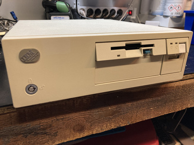

Just picked up this Model 35 SX (386SX-20, 4MB, 40MBB HDD). I've been pretty much avoiding these "faster" PS/2 systems mainly because I'm not a masochist, but I couldn resist this one:
The attachment IMG_1493.jpeg is no longer available
The thing that makes this interesting (and to my "taste") is that since it is "below 50", it has ISA bus and IDE HDD controller and regular molex connector from PSU. That means that it is almost as easy to expand as any other system, but this and model 40 are unfortunately relatively rare.
The attachment IMG_1490.jpeg is no longer available
The attachment IMG_1491.jpeg is no longer available
Only "IBM stuff" is pretty much the floppy drive. Incidentally, it is the only thing that needs repairs as it doesn't read disks currently. Hopefully recapping it and good clean helps. Amazingly, 40MB IBM HDD works just fine and some previous owner has already modded the Dallas RTC with coin battery already, so that is not an annoyance either.
