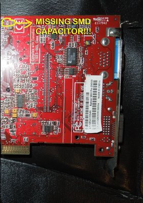

wrote:There was another picture of the back and the label very clearly said "x800 pro". Maybe it's a 9800 Pro?
It's not - it's a 9700 or 9500. The x800 PCB looks different. For one it uses either MOLEX power or a 6 pin PCI-E power connector. There are some cards (x800GTO) that do not require an auxiliary power connector at all - but none use a FDD connector. 2nd thing the X800 series have a much MUCH bigger cooler. Usually a blower style cooler - and they get pretty hot even then. If that were to be an X800 card it would not make it past 30 min in 3dmark with that tiny thing on.
That is the trademark black ATi cooler for the reference 9500/9700. The radeon 9800 reference cooler is usually larger and silver. There are cards with a smaller black cooler but it's the wrong shape. Trust me, that's a 9500 or 9700. The seller probably printed and put a sticker on the back. I'll bet my left nut it's not an X800.
It might be a radeon 9800se - crappy little card - about half the speed of a regular 9800 and slower then a 9700, but the 9800se like the 9500 PRO have only 1 row of memory modules to the top of the card - yours has two rows in an L shape. Here's what the 9500pro / 9800se look like: http://images10.newegg.com/NeweggImage/Produc … -102-303-07.jpg
EDITED - right - someone put a x800 sticker on a 9700 card. The PCB layout is completely wrong for an x800 card. Here's what the back of an x800 should look like:
https://www.google.com/search?q=x800xt+back&s … eJhcZESA9EKM%3A
