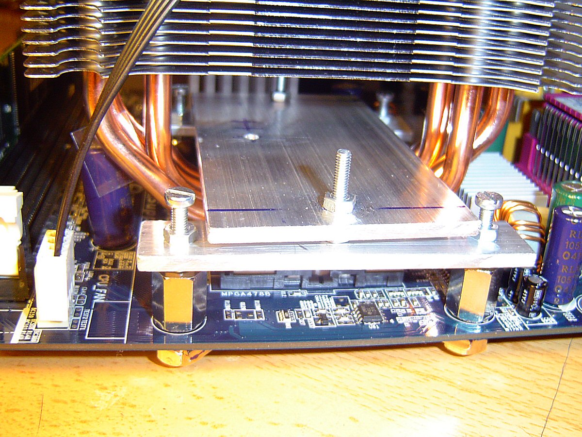

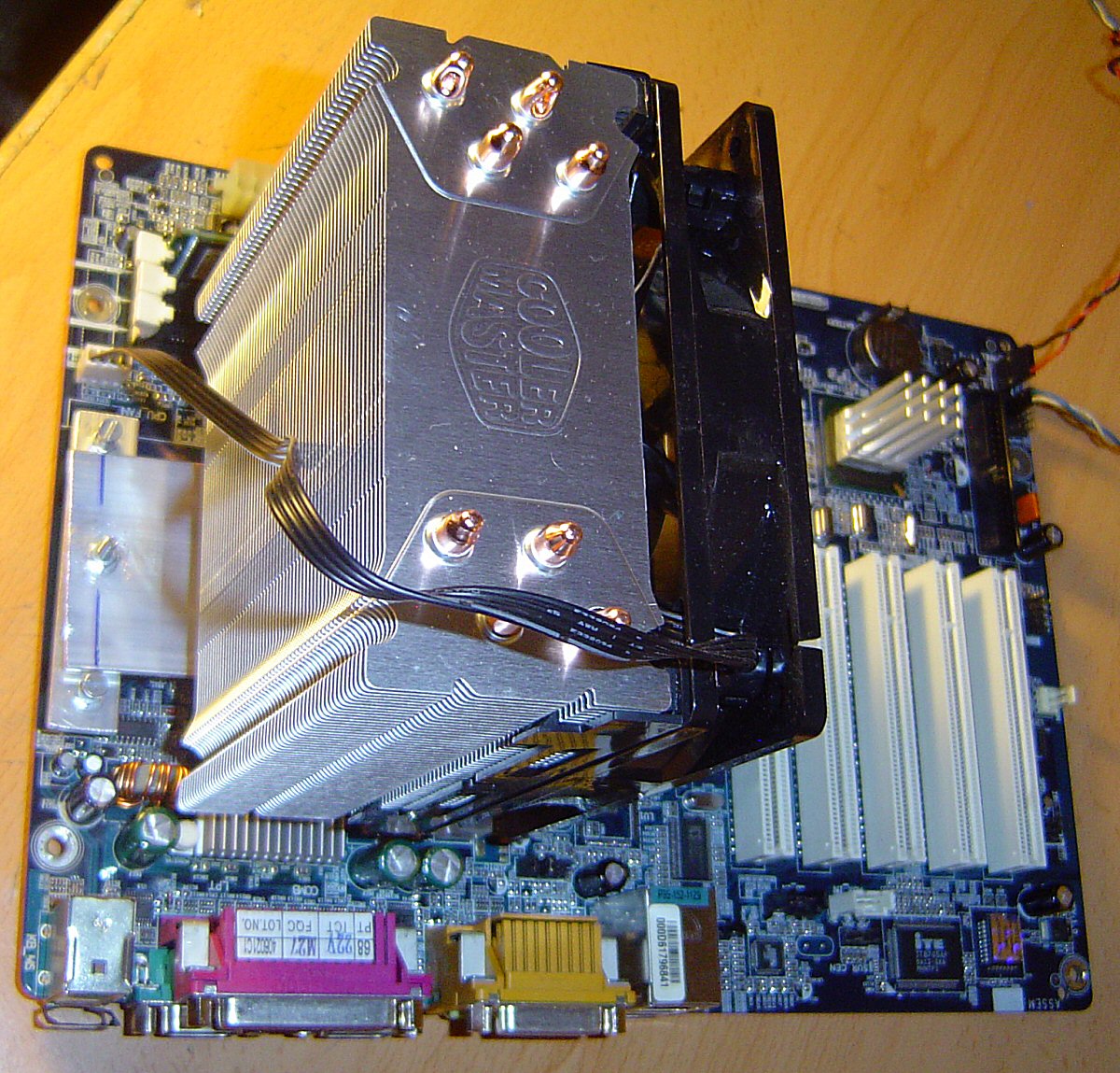

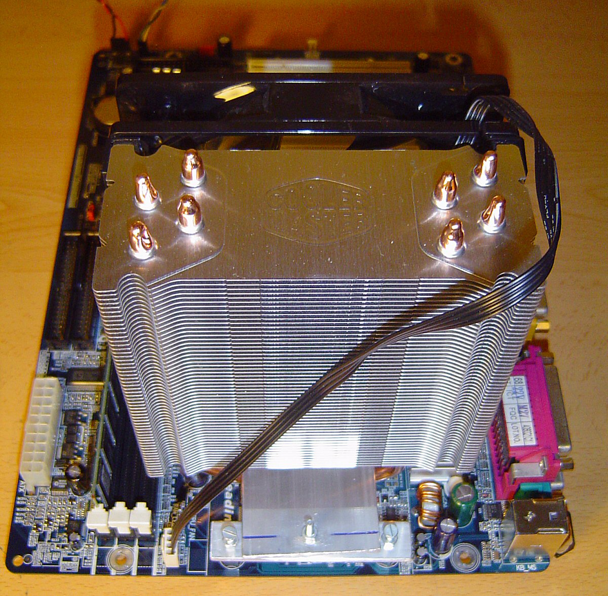

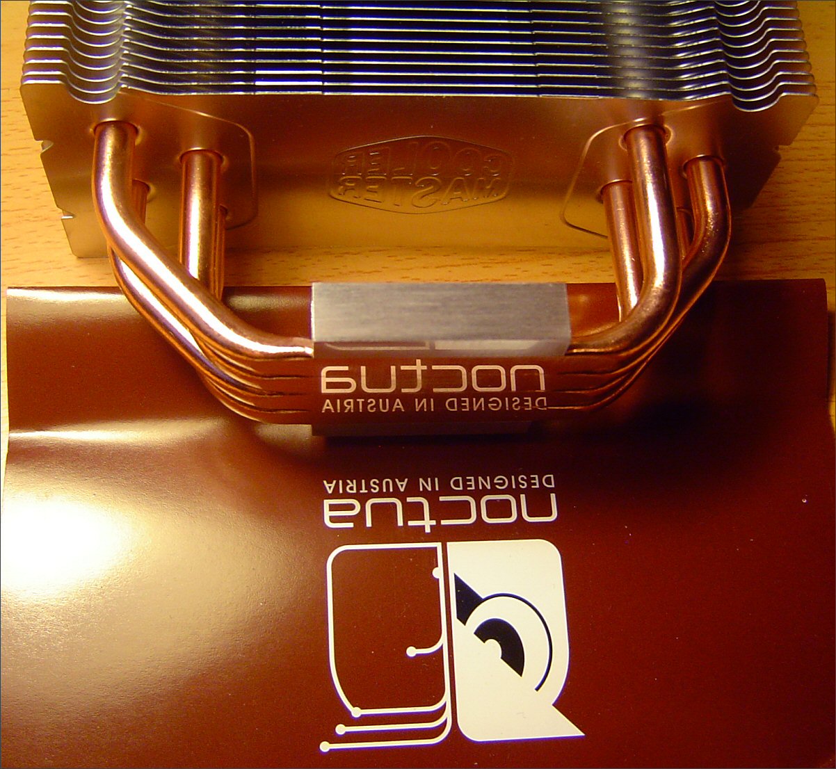

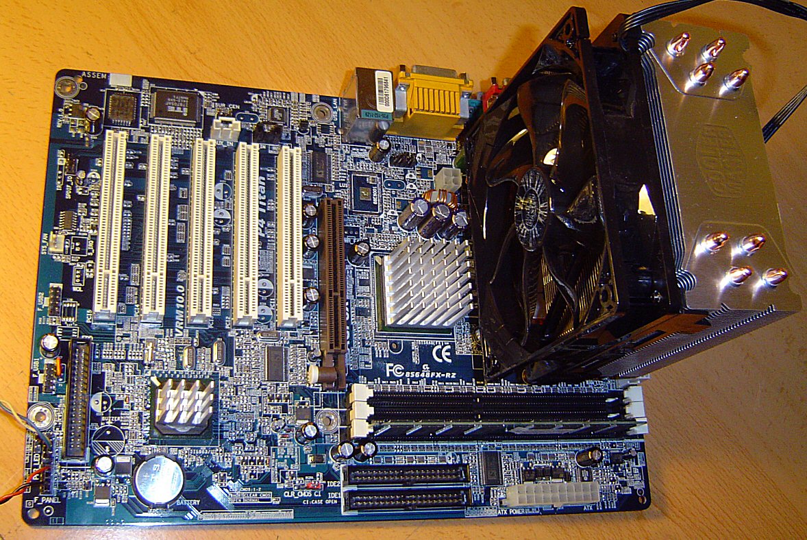

If you don't mind the refloat, I'm currently perpetrating a similar crime 🤣 , ghetto-modding a Hyper 212 Evo (superb price/performance but no gear for socket 478) on a Preshott 3.0E HT.

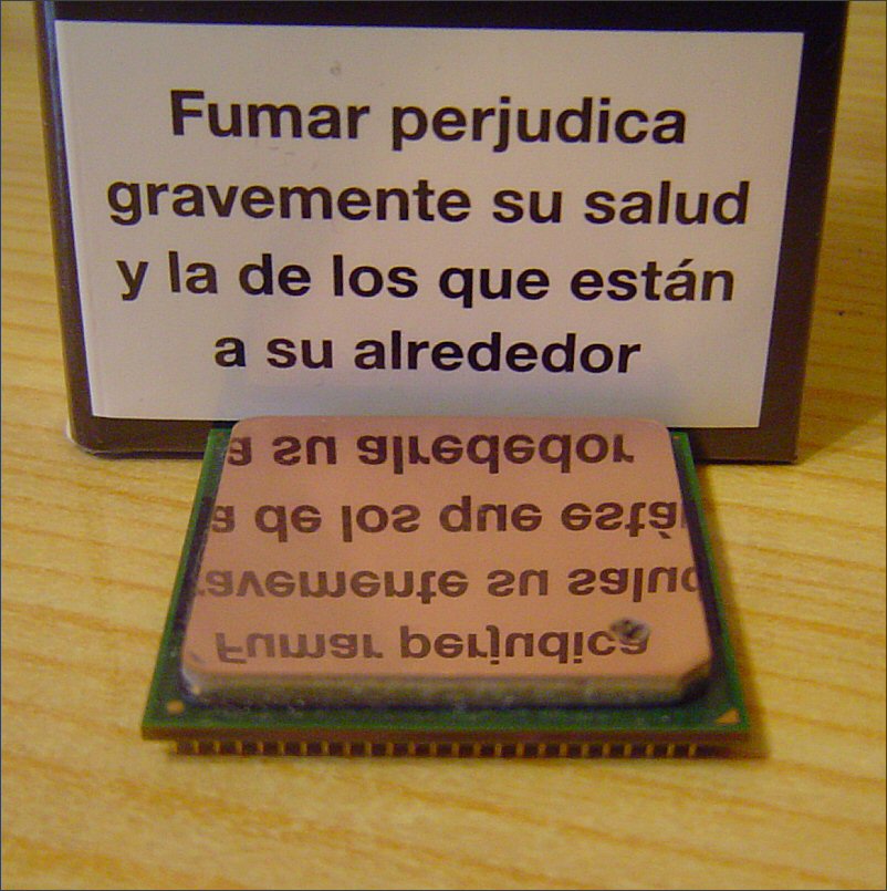

First lapped till they smiled both the Preshott and the heatsink:

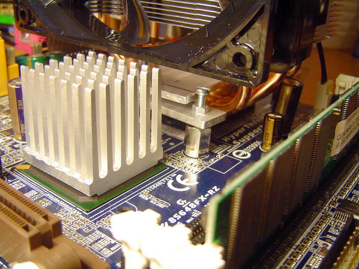

Then McGivered a 478 retention system for the 212 Evo:
Caveman crude but works like a charm:
Let the air flow!

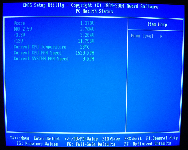

Well at the stock 3.0GHz and at 21C / 70F ambient this tiger is purring 28C / 82F idling (Δ7C), and 35C / 95F under torture with Prime95-Large FFTs (Δ14C).

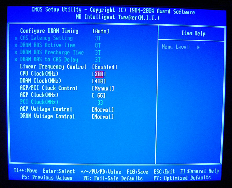

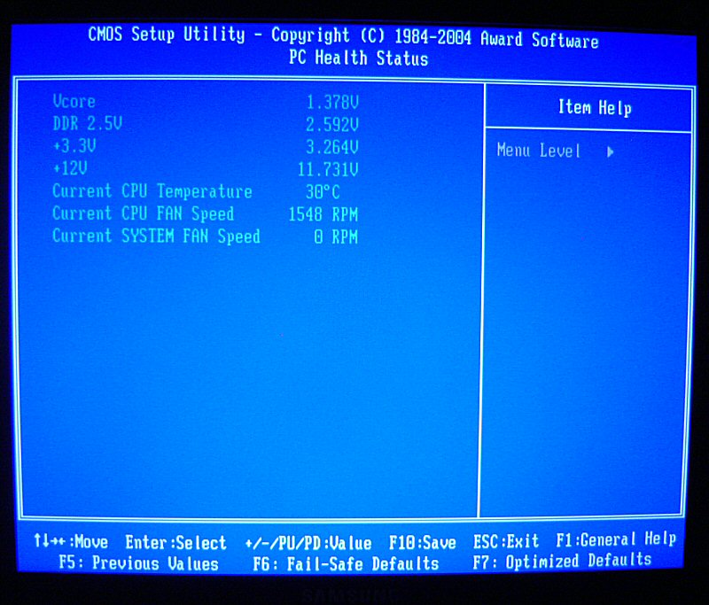

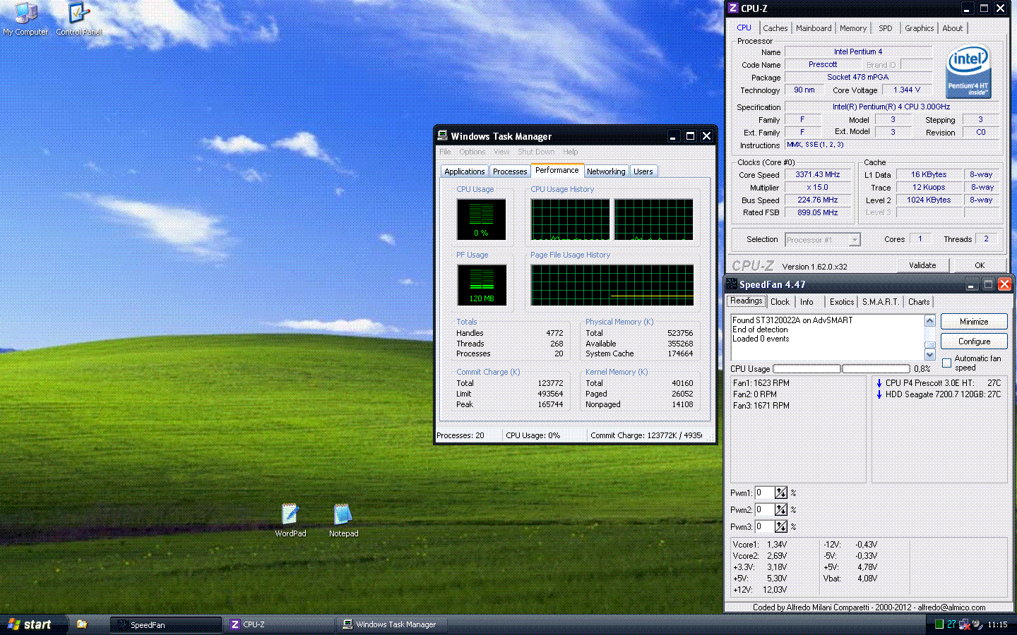

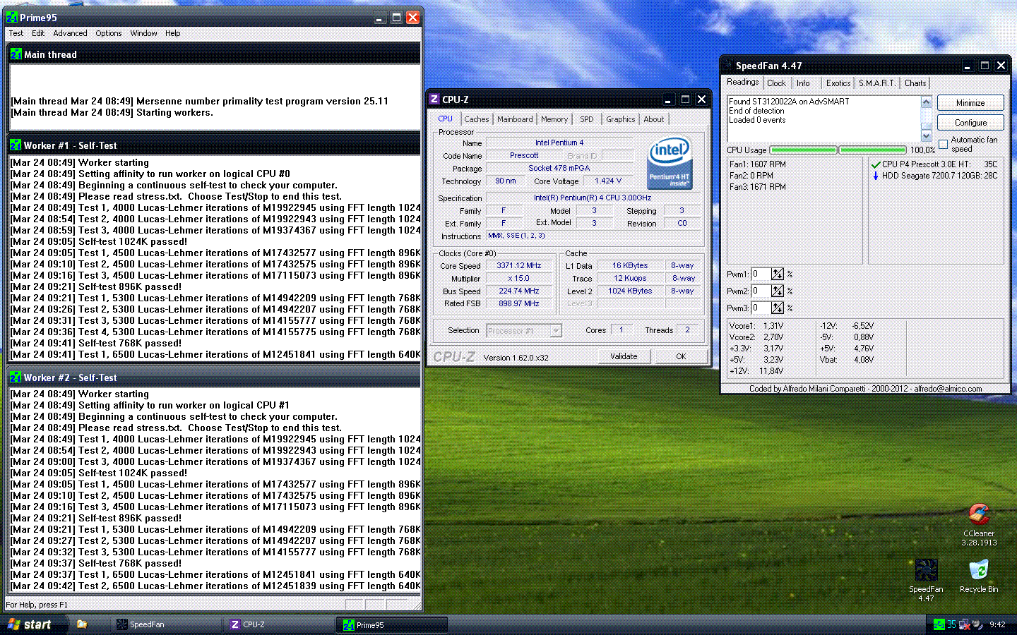

I'm unable to overclock decently, this crappy Gigabyte 8S648FX-RZ mobo doesn't allow raising the vcore 😵 , and the piece of junk generic PSU doesn't help either 😵 .
It boots into Windows @ 3.6GHz, but can't really stand heavy torture with complete stability above 3.37GHz 😒 .
Anyway with a good heatsink like the 212 Evo and sound case airflow the Preshott doesn't live up to its fame, just 27C idle & 35C under torture @ 3.37GHz & 21C ambient:
Let the air flow!
