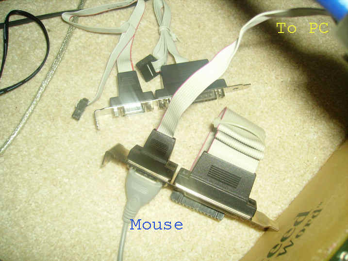

I'm getting a bit confused about something, and it's not the first time that's happened! 😉
Please see photo. I find that I need two of these cable gadgets on hand, hence the 2nd unit in the background in the photo. When I plug in a serial cable to Com Port 1 on the mobo, sometimes CTMOUSE.exe (cute mouse) says that it cannot detect a mouse. If I remove the serial cable from Com Port 1, and try the backup device (in photo), CTMOUSE.exe will work. For each 486 mobo that I try, I find that I have to try both of these cable gadgets, because one might fail. Sometimes I see ports labelled as Com 1 and 2 on the mobo (or in the mobo manual), and other times Com A and B are mentioned. Are they subtly different?
Please note: I've got 2 serial mice on hand, and I know that both of them work, it's just that for each 486 board tested, one mouse appears to fail when used with one of the cable gadgets - the "back up" cable gadget will work fine.
Thanks for any clues! 😉 😀

I guess that the bracket+ports that does not work has non-standar cabling... remember these usually came with the motherboards, I speculate that you simply don't have it's matching mobo... 😀
nothing to worry, just don't use it anymore!
and COM1 / COM A are the same... just A&B become 1&2 and vice versa only a matter of how the manufacturer likes to name the ports 😎

Ah, yes of course! 😀 These bracket+ports gadgets are intended to be used for the specific mobo they came shipped with. It's interesting how these 2 gadgets appear to work on some other mobos - perhaps there are not too many differing Com Port standards?

Yesterday I changed a pinout for a similar thing, but with two USB ports.
You should not just plug these on any mobo and hope it works, there is a real danger for damaging things as you can easily get 12 Volt on the wrong contacts.

The pinout of those RS232 connector cables is not standardized, but most mainboards have the same layout (using the simplest straightforward method to match the cable leads to both ends).
It's possible that the non-working cable uses the correct pinout, but some of the wires are broken.
The naming of the ports correlates with the assignment of resources (I/O address, IRQ):
Port | I/O | IRQ
COM1 | 3F8 | 4
COM2 | 2F8 | 3
COM3 | 3E8 | 4
COM4 | 2E8 | 3
On many boards and interface cards you can freely assign different resources to the ports (e.g. swapping COM1 and COM2 by exchanging the values). What matters is that most programs expect the resources for a given COM port to be set to the values in the table above.
About the danger of frying something when using a mismatched cable: I've used random cables on random mainboards for years and the worst that happened was that the port simply didn't work as long as the wrong cable was plugged in. This doesn't mean it's completely without risk, as the outcome depends on the electrical design of the port and the peripheral you connect to it. Theoretically anything can happen, ranging from blown SMD fuses to mainboards going up in flames.

I've blown the serial level converter on a mainboard once by shorting output to output, so yes, bad things can happen. Though only connecting a mouse might be not so dangerous in that case.
If the brackes came shipped with the used mainboard it does not neccessarily mean they fit, the seller might not have known about the difference and maybe just put random cables into the box.

https://blog.adafruit.com/2009/11/16/fixing-m … m-port-dongles/
This was mentioned by me in other topic but being bears to say again with evidence that you need to check your by pull back the black hood after undoing the nut studs.

Once you know, look for another one that is different and try that. If you don't have extra, you can re-arrange by soldering. Otherwise keep collecting more mystery cables till you find one.
