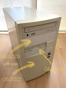

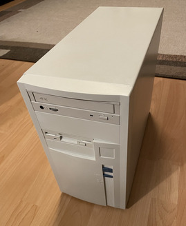

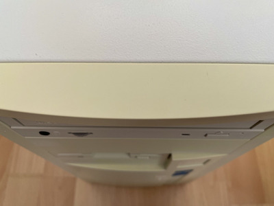

Is there any difference? 😀 i will try out the wax, looks more promising for the longterm usage. I would use the 303, if i have chance to reapply. Maybe easier to remove the wax, if it is necessary.
I retrobringted this case 8 months ago, it was very yellow… now it is yellow again (stored in a box in the dark).

I don't have a large test sample, but a case and speakers treated with 303 (applied multiple layers) yellowed again after 2.5 years at room temperature (it was also covered with a black plastic - didn't help).

I recently pulled a case out of storage that I'd retrobrited back to a nice bright beige, then given a few coats of 303, then wrapped in heavy plastic and stored in my garage. That was about 2 years ago and it's yellowed again, so I don't think I'll bother with retrobriting again in future - it can't be good for the plastic and doesn't last anyway.

Retrobrighted parts, let’s wait another year in the dark, what happens.
    331.73 KiB
    983 views

It will be just degradated even more, if you put it to the sun, even if the “color” is faded out by the sun. You should store them in a cold, dark place, if it is possible w/o oxygen.

Maybe with some coating we can slow down the process. It would be also a result, if it is yellowing again, but slower - that what i want to check. If there is no difference between the second traited parts, does not make sense to do do anything, and be honest the whole retrobringing is useless. If we can homogenize the sides, worth to invest, anyway just collect the most beige stuff, and try to store in the proper way.
