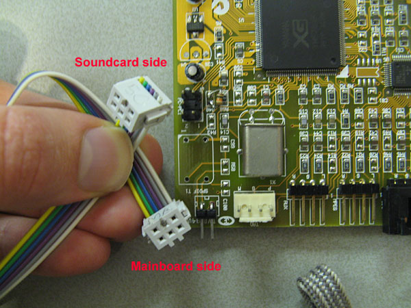

Does anyone have some guidance on how to make a SB-LINK cable to connect a sound card to a SB-LINK header on a motherboard? I imagine I could probably hack up an old CD audio cable, but I don't know the pinouts. I'd like to do this with the least amount of trial an error.
Thanks.
Reply 1 of 33, by gerwin
Behold!
    101.92 KiB
    19100 views
    Home-made SB-link cable
Reply 3 of 33, by gerwin
You don't need a crimper for these. keywords: female 2x3 RM/Pitch 2.54
In Holland or Germany you can buy such things at Conrad mail order.

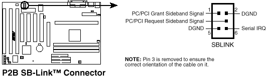

Reply 6 of 33, by gerwin
Stull wrote:
Is this cable the same pin-for-pin on both ends?
It has been a while since I messed with it, but that is what it seems to be on the photo.
Here is more info on the signals, as found in an Asus P2B Manual. DGND / 'Digital Ground' is easy to verify.

Reply 13 of 33, by Jo22
In simple words, SB-Link provides the DMA and IRQ lines of the ISA bus, so that old DOS software can program - or see -
PCI sound cards exactly the same as ISA sound cards. Unlike the other methods, this is no emulation per se.
See http://ftp.tekwind.co.jp/pub/asustw/misc/sb_link.pdf
Reply 14 of 33, by gdjacobs
PC/PCI carries ISA specific I/O information over these external cables. DDMA allows those same signals to be carried internally over the PCI bus, but it requires a compliant PCI controller. DSDMA/Ensoniq AudioPCI/Aureal etc. do it with software tricks.
