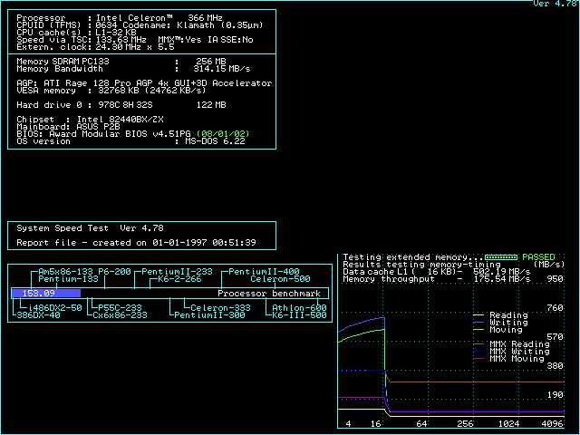

Reply 19 of 47, by retro games 100
I have just received the P2 233 "SL2HD" CPU. I set the Asus P2B mobo's jumpers to "2x & 66", and the unsurprising Speedsys result can be seen below. This score seems to reflect what other people have discovered. Although the mobo's L2 cache is automatically deactivated when running this type of CPU with the multi set to 2x, the Speedsys score is higher than that of a real P1 133.
I wonder if it is impossible to get a slot 1 system to cover the speed range from a slow 486, through to a slow classic Pentium? The corresponding Speedsys score range would be about 20 to about 100. I appreciate that you can use a very fast Coppermine in a slot 1 mobo, and then deactivate its L1 cache in the BIOS, but this produces a very slow system, roughly equal to some kind of 386, with a corresponding Speedsys score of less than 10.
