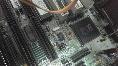

Just thought I would post my recent success with a Chaintech 486SOM paired with an AMD 5x86-133ADZ
This motherboard was obtained from eBay after noting that it has all the hardware for a PS/2 header except for the socket (Details on how to enable/use it), and my favourite chipset of this era, the SIS 85C496. It also uses an IMI SC464 motherboard clock chip which is designed to output various FSB clocks all the way up to 80MHz while providing a separate clock for the PCI devices.
This motherboard does not expose the additional clock speeds above 40MHz though as the configuration pin for these extra speeds is left disconnected and is pulled high internally, however with some careful soldering it's possible to tack onto pin 17 (SC2) and pull it to ground (no resistor needed as per the datasheet) enabling access to 30, 60, 80, and 66.6 MHz frequencies.
11.66 KiB
1597 views
Here I have done this and configured the board for a 60MHz FSB:
403.38 KiB
1598 views

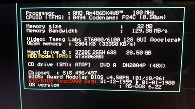

With this change I have been able to achieve a stable 180MHz clock and I have not had to relax my cache or RAM timings and I am able to complete all benchmarks and time demos.
290.3 KiB
1598 views
Attempting to clock at 200MHz (66 * 3) even raising the voltage to 5V does not post. This though might be a result of the PCI bus being out of spec causing the video card to fail to operate correctly and it might be possible to resolve this by using a 74LS93 (or similar binary counter) to divide the clock down and provide a slower clock for the PCI bus (not sure, need to spend a bit more time tracing things on this motherboard first) - JP11 already sets a divide by 2 on the clock for the PCI bus, so if anything my PCI bus is under-clocked at 30MHz, however checking the datasheet for the SIS85C497 it should be possible to remove this jumper and inject a 33MHz clock signal directly using a separate clock generator.
Later when I get some more time I will take some screenshots of the benchmark results if people are interested.

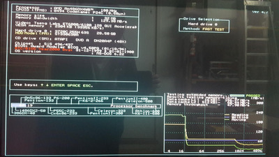

I will do this tonight now I have pulled out the machine again. Yes it supports 1MB of cache, I just upgraded mine to 512K but there are markings on the PCB to show how to jumper it for 1MB.
Also I was able to get the PCI bus to run at full speed (60MHz) after identifying that my memory timings were a bit too aggressive and the cause of hangs, not the PCI bus.
Edit:
3D Bench for Fast PCs: 100.5
Chris's 3D Benchmark: 125.3 (75.2 FPS)
Chris's 3D Benchmark (640x480): 30.6 (18.3 FPS)
PC Player Benchmark: 28.2
PC Player Benchmark (640x480): 11.8
Doom min details: 387
Doom max details. 1150
Quake: 969 Frames, 51.8 seconds (18.7 FPS)
Speedsys
325.71 KiB
1480 views

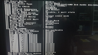

Sure thing, however I have iteratively tried every possible timing combination and had to settle on what I have here, anything tighter causes a hang just prior to the BIOS screen advancing to the next one when the OS starts to boot.
This is the output of a tool I wrote that dumps how the chipset registers are configured as this BIOS does not expose everything.
324.56 KiB
1465 views

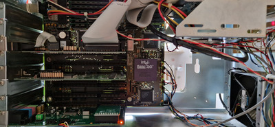

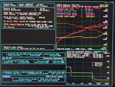

Basically bottom of the barrel for a change, but rather proud I got the 4386-VC-HD ISA board that once hosted a meager 386DX-40 fully upgraded with a 486 DX2-66 and 256K cache (inkl. Alter RAM):
1.27 MiB
329 views
993.02 KiB
329 views
1.16 MiB
329 views
Quake low: 6.5fps, PC Player VGA 8.6 with a CL GD5429 ISA VGA Card.
