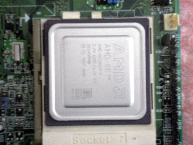

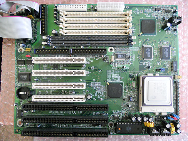

I'm looking to do a build out of a DFI 586ITBD Rev. B1 motherboard which currently has an AMD K6-266 processor in it. I've got a spare case over my folks that I will use to house the board (the board supports ATX and AT.. the case I'll be using is AT)..
The MB has 512kb cache and supports up to 256mb of memory... But I'm not sure if the chipset supports caching all of that.
I'm planning on making this a DOS/Win98 box and I've got a Voodoo2 arriving soon which I hope to get running in this system after I cobble together a patch cable for it. The main video card will be a Matrox Mystique

    AMD K6-266

    DFI 586ITBD Rev B1 Mainboard.

From what I've read, with minimal effort you can get all but one glide game to work with the V2 (dreams to reality, which apparently sucked). The V2 is a vastly superior choice if you only want to own one 3dfx card.
As for memory, you can cache the full 256MB with a K6-2, but that chip appears to be a K6 233 mhz chip (which IIRC cannot cache all 256mb of ram). You're limited to 64MB of cacheable ram on the 430TX chipset in all cases except the K6-2 and K6-3 chips which have their own integrated tag ram. You might be able to stick a K6-2 or K6-3 in that board, but you'll need to make sure that it can supply the lower voltage they run at, as well as the higher amperage they draw.

Alas, the TX chipset will not cache more then 64MB. The only way around this is by using a CPU that comes with it's own L2 cache, which are the K6-III, K6-2+ and K6-III+, all made by AMD. All the other Socket 7 CPU's don't have any L2 cache. This includes the K6-2, all the other K6's, all Intel Pentium 1's and all chips made by Cyrix and a couple others.
