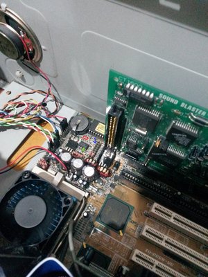

Reply 16 of 41, by James-F
Bumping this thread for it still very relevant.
I acquired a SBPro2 CT1600 (069237) and it has the same thinking noise but mine sounds like high pitched whine that changes in pitch.
The thinking noise is coming from the YMF262+YAC512 part of the card BEFORE the mixer chip.
When I lower the FM volume to 0 using the mixer software the noise is completely gone, making the SBPro2 very silent card.
Further investigation of this matter came to show that a PWM controller of the CPU/BUS on the Motherboard somehow injects noise, but I don't know whether it is on Ground, 5V or 12V but it surely reaches the SBPro2 through one of these.
Here is a picture of the problematic area:
2.23 MiB
580 views
* Red circled SMT CAP is temperature sensitive and changes the noise pitch when I put my finger on it.
* Green arrow points to a PWM controller KA3843B, the red circled cap is in its RT/CT network responsible for the frequency and duty cycle.
* Blue arrow is the CPU voltage jumpers.

Unlike the YMF719 that I regularly use, the SBPro2 interacts with the motherboard somehow and picks the slightest change in voltage, hence CPU/BUS thinking noises.
I tried filtering the noise by attaching a small ceramic caps to the ISA slot on-the-fly between 5V and GND where the YMF262 takes its power from, but to no avail, the thinking noises are still there.
So, the thinking noises come from the Motherboard/CPU/BUS and affect the YMF262 part of the SBPro2 but NOT the PCM part of it, the PCM part is actually as silent as my Yamaha YMF719...
BTW, all the PCM DAC part of the SBPro2 take 5V power from a TO92 regulator (MC78L05) on board, NOT from the 5V that the YMF262 take power from which is straight from the motherboard.
Strange isn't it? 😕
I know further investigation can actually solve the issue.
Can someone try to zero the FM volume of the SBPro mixer and report if the thinking noises are gone?
