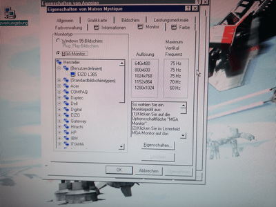

Reply 40 of 56, by anakin94
I had also to lower the refresh rate for 512x384 from 85 hz to 60 hz.
You can do this in the monitor properties.
Choose MGA-Monitor and edit an Default Monitor.

I looked at your display-settings. Please keep in mind:
- 75hz Refresh is OK for emulation which requires 50hz like an amiga/c64/atari-st etc. emulator, it's not complete stutterfree but it's OK Better than 60/70 of course.
- 50hz would be really nice, but you can only achive this by using a dos-emulator in dos or in win95-dos/fullscreen (css64 has such a mode, L365 can perhaps do this 800x600 50hz)
- 70hz is essential to get jazz2 smooth, so choose the res you want to achieve this. I recommend 640x400 for this.
- 75hz in 800x600 is a bad idea in Turrican2 T2002 because it's only smooth in 60hz. (But for T2002 you need 600mhz+)
I always choose the 60hz 1024 standard-mga-monitor and tweak only the 512x384 because this still has 85hz hard-set.
