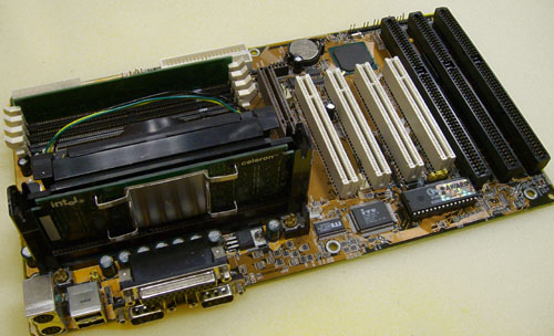

Came across this Pentium II 440BX board some weeks ago. I eventually decided it may be nice to have, Mainly because it does 50MHz to 133MHz FSB and there arent many BX mainboards with that feature. The 50MHz that is.

PRO:
- 440BX
- 3x ISA Slot
- 50MHz FSB setting
- Both jumpered and BIOS FSB and Multiplier configuration.
- Allows 66MHz FSB CPU's to run on 100MHz or more (JP45).
CON:
- The v1.1 board VRM does not go below 1,8 Volt. Coppermine core Pentium III CPUs request 1,75/1,65 Volt.
- Counts/Checks the RAM at boot, can be skipped, but not disabled entirely.
- Does not allow a 100MHz FSB CPU to run below 100MHz FSB.
- Where is the AGP divider setting?
- No hardware monitor chip mounted

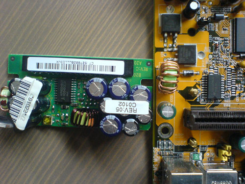

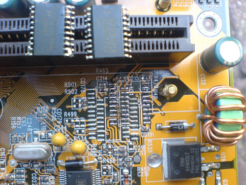

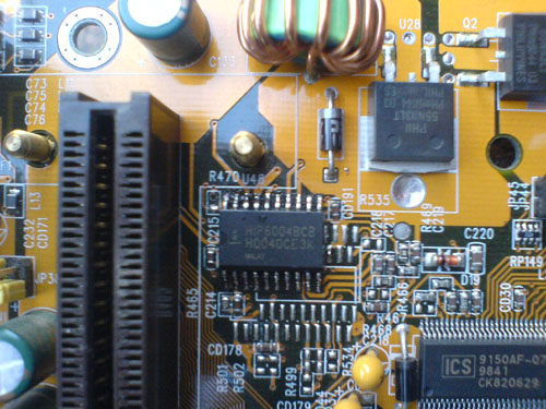

A coppermine could run on this board when modded to request 1,8V. So there was no BIOS limitation. I wanted to try and upgrade the VRM so it supports the normal coppermine core voltages. So I needed to replace the hip6004ACB chip with a pin compatible hip6004BCB. The legs seemed large enough to consider (de)soldering this chip. Unfortunately I could not find this chip anywhere, or any compatible one for that matter. And I did not want to buy an entire mainboard just to scavenge a VRM. Later I came across a picture of a mislabeled XEON CPU with VRM module, and it occured to me that such modules may hold what I need. And they do.
The board now runs with coppermines. the voltages are spot on. But the combintation of a coppermine with 133MHz FSB is not reliable:

The smoothing capacitors for the core voltage do look small compared to later boards. They are 6,3V 1000microF, 8 pieces.
Anyway this is not too big a deal. I am already happy my soldering action did not destroy anything. 😉
    82.19 KiB
    1265 views
    VRM upgrade complete
    90.58 KiB
    1265 views
    VRM upgrade

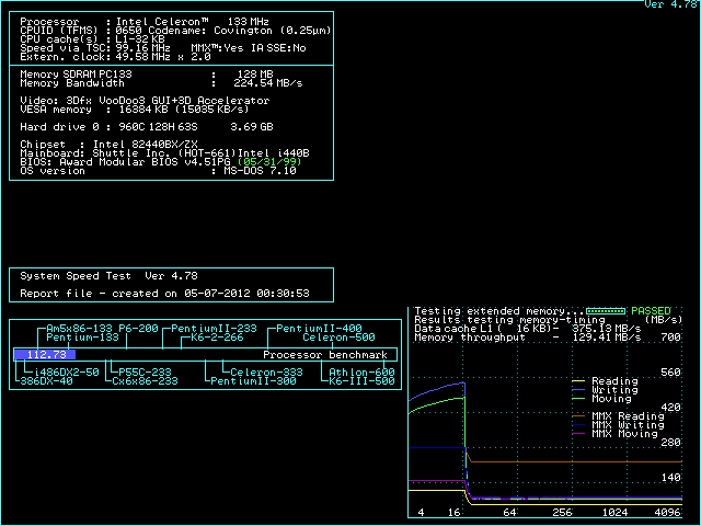

Reply 1 of 11, by gerwin
Speedsys results with Deschutes at slowest setting.
    10.03 KiB
    1258 views

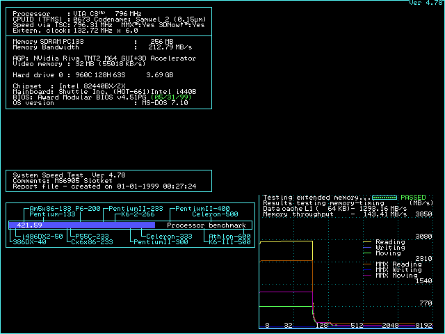

That 133MHz FSB instabilty was my obervation as well. This board is in storage now. Last time I ran it was for compatibilty testing with VIA C3 processors: It runs with C3 Samuel 2 but not with Ezra-T or Nehemiah.

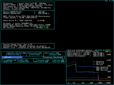

I also noticed a speedsys screenshot of me running a Tualeron Pentium III on this motherboard, using an UpgradeWare Slot-T adapter.
HOT-661 is a nice board anyways, but the GA-6BXC does the same without the limitations mentioned. When messing with the C3 CPU's I was wondering if it was a BIOS limitation, and at some point decided to flash the 6BXC BIOS to the HOT-661: It seemed to work fine. That is one way to get rid of the RAM counter at boot. 😀 Late model C3 CPUs still did not run though.
C3 Samuel 2 at 6.0x133=800MHz, using MS6905 adapter.

Reply 4 of 11, by gerwin
Tualeron QEL8ES at 4.0x50=200MHz, using UpgradeWare Slot-T adapter.
