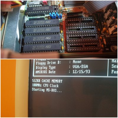

Let me add fresh info on this topic, as I am currently- in 02/2019 - building my 486 nostalgia machine based on Shuttle HOT-419 DZ R2 motherboard
http://www.elhvb.com/supportbios.info/Archive … 419dz.htm#hd001
My board was, as I bough it, fitted with full banks of Alliance CMOS SRAM chips (4pcs AS7C256-20PC and 4+1pcs AS7C1024-20TPC), but on startup it says the cache memory is bad and I need to disable it.
So I figured it would be best to get new chips, rather than figuring out which are bad and which are not.
I just bought these off Ebay↓ I figured that with these types and qty, I can try both 256K and 512K cache configs that my MB should support, and have a piece or two for spare:
5pcs IS61C1024-15N IS61C1024 128K x 8 HIGH-SPEED CMOS STATIC RAM DIP-32
Link below - 7,63 USD for 5pcs
https://www.ebay.com/itm/5pcs-IS61C1024-15N-I … &frcectupt=true
10PCS IS61C256AH-15N Encapsulation:DIP-28,32K x 8 HIGH-SPEED CMOS STATIC RAM
Link below - 12,70 USD for 10pcs
https://www.ebay.com/itm/10PCS-IS61C256AH-15N … ~RzH:rk:18:pf:0
I will update you if and how they work with HOT 419 DZ R2 mobo, once I get them
Reply 10 of 14, by amadeus777999
Different sizes most likely do not work correctly - this might cause the "cache memory is bad" display. Could be afew other reasons too.
Does the HOT419 support 1MB of 2nd level cache? Normally smaller modules mean less trouble but in your case both of your options are fake ones, so it's a bet either way.
Buy both and take dead ones into account.
Reply 11 of 14, by assasincz
I follow the manual I link to in my post above, HOT-419 DZ R2 supports up to 512K cache.
256K is done by 4pcs 32k x 8 chips in BANK 0, 4pcs 32k x 8 chips in BANK 1, with 1pc 32k x 8 chip for Tag RAM
512K is done only by 4pcs 128k x 8 chips in BANK 0 (BANK 1 empty), with 1pc 32k x 8 chip for Tag RAM
We shall see
Reply 12 of 14, by assasincz
assasincz wrote:
We shall see
So...an update is due,
Well the 32k x 8 chips arrived a few weeks ago. I replaced all SRAM chips on board with these (4x in Bank 0, 4x in Bank 1, and 1pc tag ram) for 256kB cache configuration, set the jumpers as per manual, enabled external cache in bios - but the computer would not boot, I do not know why. After some troubleshooting, still nothing
Today however the 128k x 8 chips arrived. So I gave it a go, put 4pcs in Bank 0, keeping the 32k x 8 chip for tag RAM, and removing all other chips from Bank 1, set the jumpers as per manual and SUCCES!
I am now thinking there is something physically wrong with bank 1 on my board, but no matter - Now I can bask in glory of enhanced performance (irony alert) but it makes me happy to max out the setup in all possible ways.
