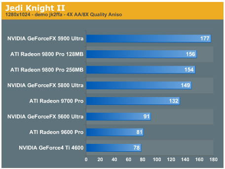

Indeed the NV2x generation has great anisotropic quality but it takes a considerable performance hit when using it.
If you run AA + AF, things really get ugly in comparisons between GF4 and FX.
http://www.neoseeker.com/Articles/Hardware/Re … 900ultra/8.html

Reply 11 of 24, by F2bnp
Granted these tests are with 4x AA and 8X AF on, which is pretty much a killer combination, memory can be deceiving. I remember playing 3D games smoothly on my Pentium 133 and S3 Virge. 😜 Kind of a far fetched example, but you get my point!

sgt76 wrote:
Is that all how powerful a 4600Ti is? I remember it being pretty godly... I even played Far Cry, HL2, FEAR, NFS:MW, etc @ 1024x768, at reduced settings of course, but still pretty enough.
Yeah as others said those tests are with anisotropic filtering and anti-aliasing and NV2x takes a major hit with either. Run without those and it speeds up a lot.
