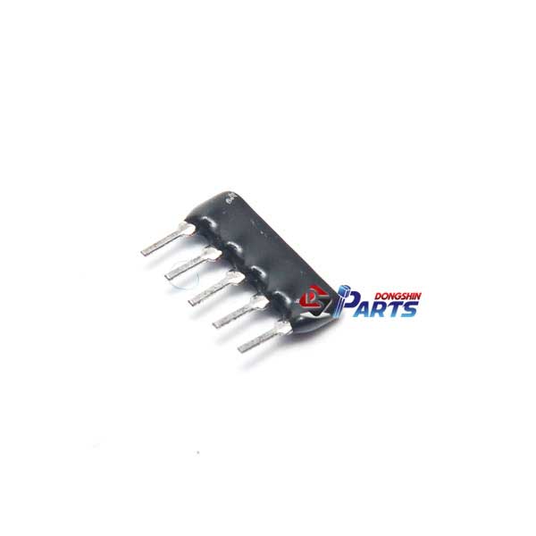

I bought a 8bit ym3812 soundcard and its condition is like picture attached.
What does I should to buy and soldering it? Is it a capaciter array? If so what type I should buy?

133MHz wrote:
Could it be the same as the "ACT-1" part that can be seen in the second picture?
The problem is the "ACT-1" part have logo of Covox. "ACT-1 Covox 56". I don"t think I exactly find it anywhere.
The thing in the picture looks to correct. (Every sound blaster have it.) But I don't know its exact capacity.

Reply 4 of 13, by luckybob
the thing you pictured is a resistor network, and are not used in soundcards, at least not in the audio out area.
in all likely hood, the missing part is a LM383, or something very similar. NS_LM383T_IC.jpg
Reply 5 of 13, by Jepael
Definitely a complex IC. It is similar to the other module so it is something with custom markings. Impossible to say if it is a voltage regulator or some kind of amplifier. But it is definitely not a simple capacitor or resistor network.
Can you scan each side of the sound card so that we can see better where it connects to so we could have an idea how to replace it. I'd be glad to help fix it.

Reply 7 of 13, by Old Thrashbarg
I hate to say it, but you may be SOL.
I don't think it's an amplifier IC, but even if it is, I wouldn't count on it being replaceable with a standard part. It looks like a thing called a "couplate". Very common in old radios/TVs. They basically combine a network of resistors, capacitors, and sometimes transistors, into a single molded unit (for various reasons... space saving, temperature stability, shielding, making more money off proprietary parts, etc.).
Normally they can be recreated fairly easily with discrete components, but that's only when you have a schematic to show exactly what it does. Reverse engineering them blindly tends to range from extremely difficult to impossible without special equipment. And I can't say I've ever run across a full schematic of a Covox card.
