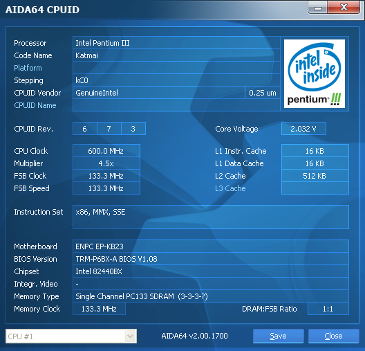

Reply 3 of 29, by TELVM
Katmai 450 @ 600:
