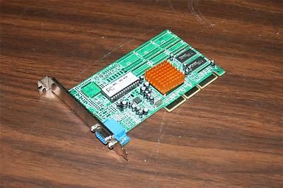

Got this videocard,no idea what this is,it has no serial number that i can search on the internet.
Vyl7EYU.jpg?1
qybpVzQ.jpg?1

Not completely sure, but the "305 AGP" makes me wonder if it could be a SiS 305 based OEM card of some sort. Anybodys guess which manufacturer it might have come from though.

Sis 305,never heard of that graphics chip,i'll look it up on the internet,thx for the info.

I think it was mainly used as integrated graphics on SiS chipset motherboards. But I've seen some SiS 305 cards for sale on ebay when looking for retro parts, so I would guess this might be one of these.

the closest match i found was this, a HIS 305 AGP card.
22.85 KiB

SiS 300, 305 and 315 were released between the Savages and the Xabres. Strictly budget cards.

Otherwise, if it is the SiS 305 based card then you can forget about gaming (atleast half-life1 & newer ones). maybe dos games will be ok. I have a sis 630 chipset based motherboard which has an integrated sis 305 and I can't get more than 17 fps in halflife.

Didn't find a lot of info on the internet about it,it's succesor the 315 had somewhat better performance,equivalent to a geforce 2 mx. http://www.xbitlabs.com/articles/graphics/dis … lay/sis315.html

SiS305 AGP 32MB i tested have 69,9FPS in glquake 640x480 - see http://vgamuseum.info/index.php/benchmarks/310-glquake
Thats right between Savage 3D and Savage 4. For example Ati rage 128vr 8MB have 81FPS and vanta LT have 100FPS. So its comparable to slowest 2nd gen 1998 3D cards, but this one came out in 2000. So usable only for collecting, almost everything you got almost for free is faster than this. In 1024 have only 29fps, so its unusable in higher resolutions too.
In unreal 640x480 - 33,5FPS - http://vgamuseum.info/index.php/benchmarks/311-unreal

So I put together a similar rig to compare results: K7S5A, Athlon XP 1700, SDR, 133 MHz, 32MB 305 125/125, driver 1.15.
GlQuake numbers were about the same, but Unreal was running bit over 40 fps average. I really suspect AGP bombed for the relevant SiS cards, better check it. Half Life is fine up to 800x600. By the way I see your i740 did also 40 fps in Unreal, that is impossible if the lighting is rendered correctly, check that one too.
