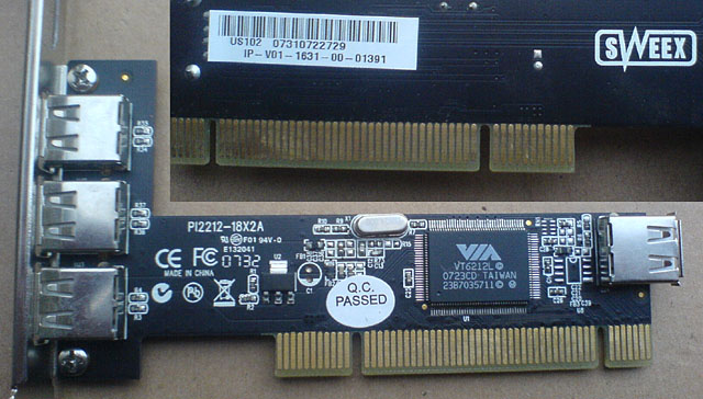

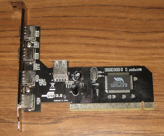

I just want to use it for storage. USB 1.1 is so slow. Can you guys post photos of your cards that do work on 1997-1999 boards?
The card that I have is some ultra cheapie with a VIA VT6212L but it simply doesn't work on chipsets before 2000-2001. My guess is the controller isn't the problem, the card's construction is.

Reply 11 of 396, by gerwin
This is the one I was talking about, Which served me well when attached to a SY-6BA+III i440BX Motherboard.
A totally unremarkable piece of hardware...
Reply 12 of 396, by GeorgeMan
It's an old design, probably it was still compatible with PCI 2.1 back then.

Reply 18 of 396, by zyga64
I have exactly the same card. Working without problems on Intel SE440BX-2 (third slot - counting from AGP). System is Windows 98SE
Driver from here: http://download.viatech.com/DownloadDriverSvl?driver_id=2105

Reply 19 of 396, by swaaye
Interesting. I couldn't get either board I tested it on to even detect that the card was installed. I did try every PCI slot too. Maybe the card is broken.
The thing is - in the past I had another one of these and I remember having this problem then too. But it worked ok in a KT266A board that I had at the time.
