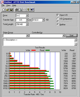

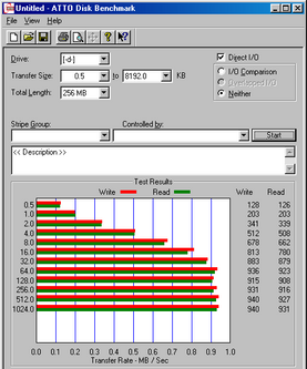

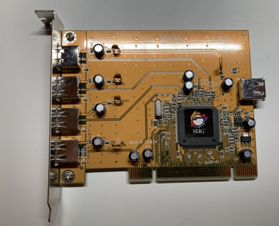

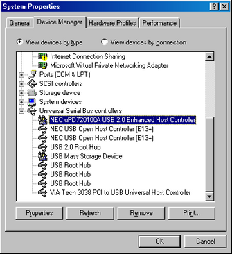

Another +1 for NEC chips. I picked up this SiiG branded card today. USB 2.0 works fine under Windows 98 (NUSB36E.EXE) and OpenBSD 7.0.
Attached are benches against the onboard USB 1.0 VIA chipset (FIC VA-503+), K6-2 500MHz, using my fastest Sandisk Extreme USB 3.0 USB drive. It's about 0.9 MB/s vs 7.5 MB/s. One of the devices shows up with the multimedia icon, I thought that was interesting.

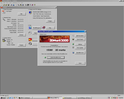

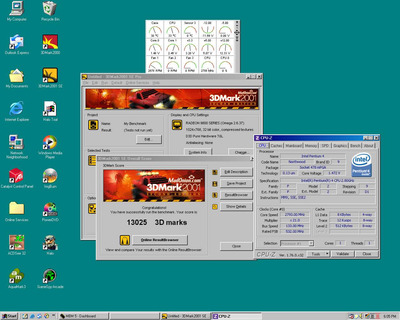

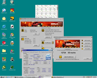

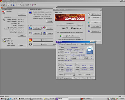

There was a recent thread that detailed the performance hit that a Pentium 3 system had with a USB 2.0 card, and that got me thinking about my "Weak" Pentium 4 system. Amptron M930, 2.8/533/512 P4, SiS 645, one gig of DDR @ 266 MHz, a Radeon 9800 SE with Omega drivers unlocking the extra four pipelines, and Win98SE.
This system had an Nvidia two port USB 2.0 card in it when I rescued it from a junkpile, but I wanted a USB 2.0 card that had front USB ports, and I finally found one. So I installed the NEC card for the front ports, but left the Nvidia one installed as well. I decided to test it with several benchmarks with both USB cards, neither, and just the NEC card. Removing the Nvidia card boosted the 3D 2000 score by about 400 points, 3D 2001 by about 300, and Aquamark increased by over 1,000 points. The system tested the same with the NEC card installed as it did when it was removed. So the Nvidia card is not going back in this machine.

Reply 159 of 308, by slivercr
They are useful for occasional file transfers though, and Disabling it in the Device Manager restores the performance.
I'd rather Enable/Disable the device than transfer files over USB1 speeds 🤷
