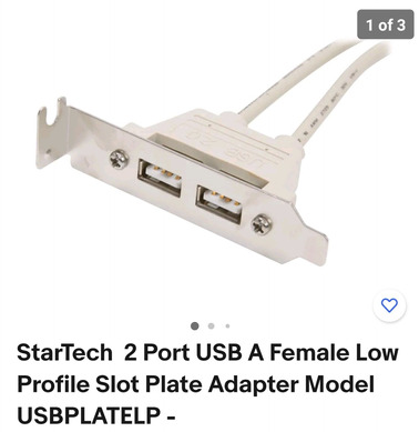

There is an NEC USB 2.0 card with a low profile bracket and no ports on the slot; only two internal ports at the back. You can use this with a second bracket and extension cables that can mount to it.
Here is a photo of the bracket.
109.27 KiB
1502 views
And here is the card. I don't know if you'll be able to find one with the low profile bracket, but you can measure the whole to see if there is a compatible one. Or 3D print one.
Most manufacturers buy parts like these brackets off the shelf. So there is a good chance that you'll find something compatible. You can also measure the wholes and see if there is a compatible part available new.
Actually, you can skip the bracket entirely. You don't need it so long as you're not bumping anything. I used this card once in a slot adjacent an Audigy 2 and put the gameport bracket there instead, so as not to lose a slot.

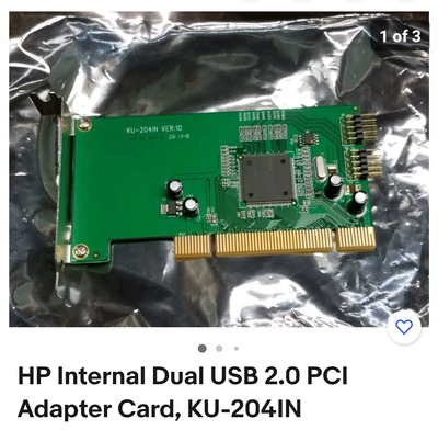

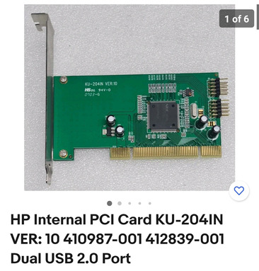

Reply 246 of 312, by Kahenraz
Nope, wait. I found one with the low profile bracket. You're all set. It does require an additional slot for the USB ports, but this isn't even necessary of you want to route them through to the front of the case.
This is on eBay and there are several of them available from the seller.
One caveat is that these are NEC's first generation USB 2.0 controllers. They are not as fast as the subsequent part numbers, but still much faster than USB 1.1.
