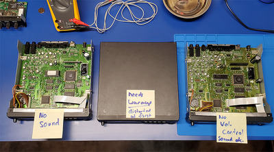

Started work on repairing not one, but three Korg 05R/W sound modules.
I'd been collecting them hoping to find a fully working one, but it seems these units are highly prone to failure.
Started working on the one on the right, having already replaced a few caps which seems to have corrected issues with distorted sound/extended warmup. But looks like it will also need a new potentiometer as the volume control isn't working.
Once I get to a fully working one, I'll repeat the repairs on the others and hopefully wind up with three fully working units.

As an owner of several synthesizers, I've found cracked solder joints at the back for the MIDI, RCA connectors, and mechanical/ground legs of these connectors, to be a common fault.

That's a good point.
On the one unit I started working on, it did have cracked solder joints on both the power connector and one of the RCA connectors. I reflowed both of those connectors.
