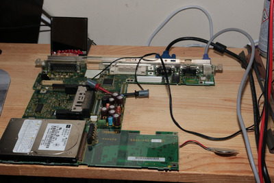

Prepping to modify a Toshiba T2130CT motherboard replacement. I could only get a T2110CS (dead from corrosion & refunded) and a T2100CS. Since I'm trying to make this CS (DSTN) motherboard into a CT (active matrix) motherboard and want the faster CPU. I need to swap the graphics chip, the CPU and a few components around the graphics chip. Lots of fine pitch QFPs, yikes.
Sure do wish parts were easier to get for these things - but at least the motherboards are the same across all of these models. The T2100CS board has the same external floppy connector footprint that only was used on the T2150CS/CDT models.

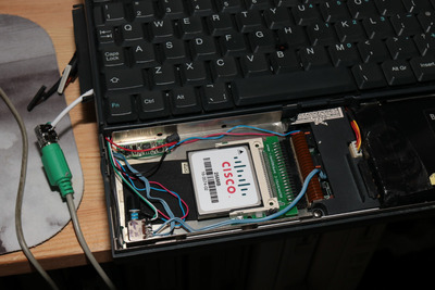

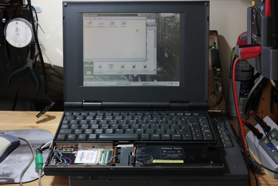

Of course I'm doing a few other things alongside that. I'm kind of going through my collection of laptops and deciding which ones I really want to keep - this FMA9500 mono screen laptop is one of my favourites because it's such an oddball, but the mouse pointer's controller is broken so I've been trying to re-route it to an external mouse.
Now I've modified it so that there's a PS/2 cable for the mouse that goes through the PCMCIA bay's gaps, I didn't even need to cut the plastic housing to add the PS/2 mouse port. And it can just fit into the slot when I put it away 😀

Don't often see Win95 on a monochrome display!
I need to go through my laptop collection and thin it down too, but I can't bring myself to do it!

It came with that OS already installed but the hard drive failed and this install is a homage to it. The original owner seems to have been okay with win95 on a monochrome screen for a while, probably since it would be full colour with a CRT.
It's not going great since I acquire more quite often, but some just don't fit the eras I want to cover or the screens are messed up - my other mono laptop, the AST Bravo NB 4/25's LCD polarisers broke down and I can't get it looking right anymore so I'm wondering now why I have 2x mono laptops. The AST is a Sharp LCD where the polariser failing seems to be a common fault, I hope it never happens to my FMA9500 which has an Epson mono LCD.

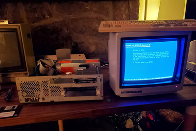

Spent the evening once again wrestling with my Tandy 1000 TL/2.
I had originally thought that using the Blue Lava Systems XT-IDE adapter had solved my problems. The adapter and stock boot CF card they included appeared to work.
However, I tried playing Space Quest I this evening and started running into periodic freezes when loading new screens. I then noticed that CHKDSK, FDISK and Norton System Info would all cause the system to lock up. So clearly something was not right.
After a bunch of troubleshooting, I ended up installing a brand new Lo-tech XT-IDE card and set up a new CF card with MS-DOS 5.0. After doing this all the above utilities now appear to work. We'll see if this configuration ends up being more stable.

Due to minor differences in geometry translation and there not really being an official standard until midway through the 1990s, minor differences meant that not every HDD formatted on given controller, with given BIOS and chipset, could necessarily be read on a different machine with a different controller/BIOS/chipset. The problem seemed to go away totally after ~27GB limit was sorted out, existed in edge cases in the post 8GB days, and everything before that, 90% of the time it worked all the time, though things get worse the further back you go. Maximum reliability on anything older than about 1998ish is best achieved by formatting your IDE drives on the machine you're gonna use them on... even though XT-IDE code and hardware is later you've still got original BIOS and chipset quirks that might pee in your cheerios. Some of it might be due to lack of care in making certain timing operations independent of processor execution speed.

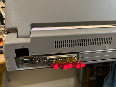

I've been trying to resurrect a Toshiba T2130CT laptop and it's proving tougher than I would have hoped. This is replacement motherboard #2 and until a few minutes ago, it was broken. Troubleshooting a laptop motherboard wasn't what I wanted to do but getting replacement parts means even more waiting.

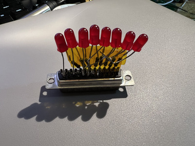

I'd seen a blog post here a while back about the Toshiba LED code reader that connects into the parallel port: https://nielssp.dk/2019/09/fixing-410cdt/
So I made my own, can't find schematics but it's pretty simple to put together, just connect some LEDs to pins D0 to D7 on the parallel port. I used 150 ohm resistors so they wouldn't burn out and then covered it all in hot glue. Now I've got a special Toshiba password removal dongle and this post code reader dongle.
The attachment IMG_3175 (Custom).JPG is no longer available

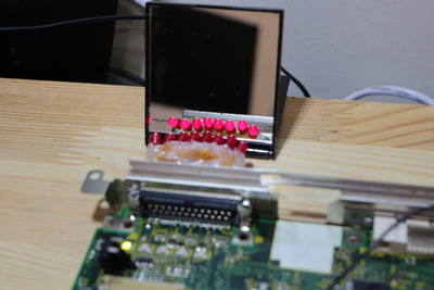

In action it blinks through some codes as a binary counter:
The attachment IMG_3174 (Custom).JPG is no longer available
On my dead Toshiba T21xx board it was doing still nothing and I was gonna give up and contact the seller to get another one. It would just light up all the LEDs at once.

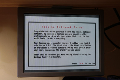

That Toshiba pre-load I mentioned a few days ago, that was on this hard drive appears to somehow be an actual complete pre-loaded hard drive that's not even registered? I'm confused how this could be since the T2130 predates recovery CDs.

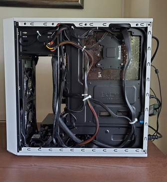

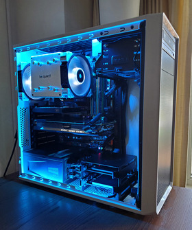

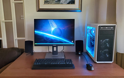

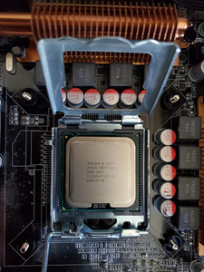

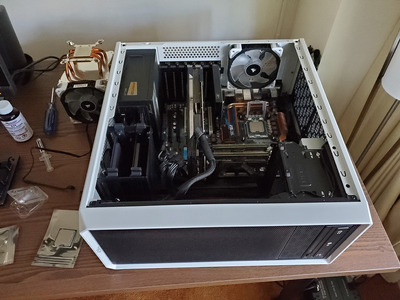

Swapped out the CPU on my 'ultimate' Windows XP machine going from an E8400 to an E8600 processor. Not a huge change, but faster is faster. 😜
Also did some cable management tidying up. I think I'm finally done tinkering with this computer and it's set up the way I want it.

Nice, klipsch promedia. Hard to get those in the UK nowadays.

Looks good. I had an idea of this similar setup but a 486 inside.
