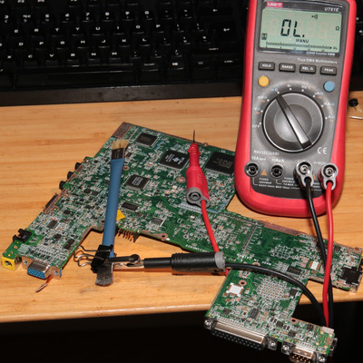

New tool that I've never needed before - this makeshift one works well enough but is pretty unwieldy. I remember seeing a video on the 'mikeselectricstuff' channel years ago but haven't ever really needed to find this kind of thing before.
The attachment IMG_0621 (2) (Custom) (1).JPG is no longer available
It did work though and let me figure out where the trace goes in this rather complex (and non-functional) little Thinkpad 240X motherboard. I'm trying to figure out how the backlight turns itself on since I broke that signal on my otherwise-functional Thinkpad 240Z. All this because I wanted to swap over the screen plastic and put on a cable cover that was missing, this all has gone very wrong but I can call it a 'learning experience' 😁
Oh yeah and in the process I found that another Thinkpad 240 mainboard I thought was dead was actually working - that and the dead Thinkpad 240X were in the 'box of shame' for a couple of years, along with a screen missing its backlight cable. I built up that Thinkpad 240 (celeron 300) into another working laptop and gave it an LED backlight, very nice upgrade for this little system 😀

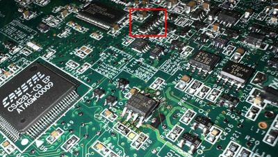

My Thinkpad 240Z is back up and running, traced the backlight enable signal back to a little AND gate, swapped that over from the donor 240X board and now the 240Z's backlight works again, yay.
One of the two little components circled in red was broken. While I was in there I found some previous work that wasn't me:

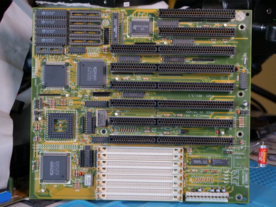

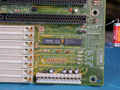

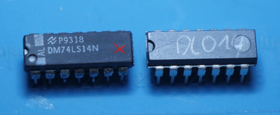

Currently working on a M321 - 386-40MHz PC-chips motherboard. -> https://theretroweb.com/motherboards/s/pcchips-m321-rev.-3.x

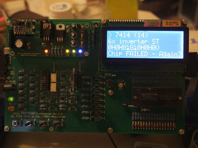

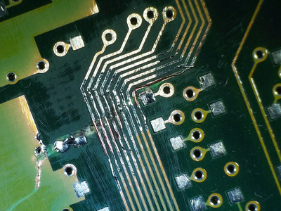

Leaking battery ... Have removed the keyboard controller, bios and the 6-way Schmitt trigger 74LS14. The 74LS14 is destroyed.

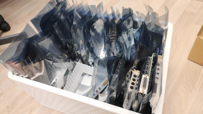

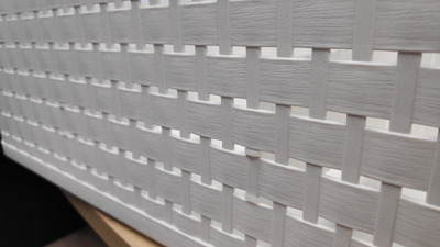

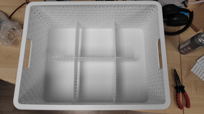

Finally figured out how to keep my collection of sound and video cards properly while still being able to quickly access them. Now, all cards are instantly available to me and not hidden behind other cards or anything like it.
Until now, they were very disrespectfully held in bunch of shoe boxes without any bags or other kinds of protection. Now they've got an earned respectable place.

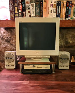

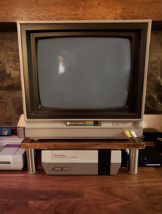

handsome.
Reply 23138 of 29871, by Kahenraz
I really like the look of the synthesizers beneath the monitor.
Reply 23139 of 29871, by chrismeyer6
Shponglefan wrote on 2022-11-13, 23:54:

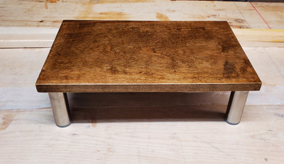

Build myself a few monitor stands for my retro setup this past week. Nothing fancy; cut and finished some plywood, then added Ikea Eket metal legs.
Your stands look great. I want to do something similar to get my tower a bit off the floor
