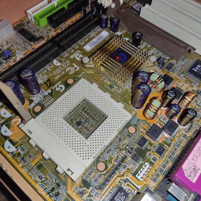

Got one of my projects some head start. Started building some sets, P3 650 vs Athlon 650. Bought a radeon 7500 and looking for Geforce2 ti to company the P3. The Athlon mobo need recapping but it works.

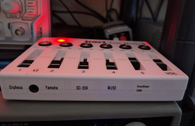

Went on with little GM modules shopping spree lately. Got:
1) SC-55K from Yahoo Japan
2)E-Wave add-on from Serdaco for Orpheus
I already had Yamaha MU50. From full main stream coverage GUS midi was missing. Then I stumbled upon Hummtaro fantastic soundbanks thread. Good reason to dust off my X3MB. WoW! Recently added GUS SB sounds very close to real one.
Today I got little bit more organized. Bought one of those cheap label printers finally. Result - pic attached!
Yamaha is YMF744 PCI card with it's fantastic XG synth exclusively for Win98.
Now I have filled all my mixer channels. No room for upgrade..
Although I'm reading that there is a limit to midi-trough daisy-chain setups. I'd like to keep it so. I'm enjoying a lot on the fly music switching ability.
Note to myself before upgrading - Be patient. Wait for Orpheus II and you'll get automatically many free slots for your mixer while keeping same options...
Reply 23184 of 29833, by Kahenraz
I found that there was a delay caused by daisy chaining MIDI modules. I don't remember the testing method, but it was very noticable. A mixer is the optimal solution.

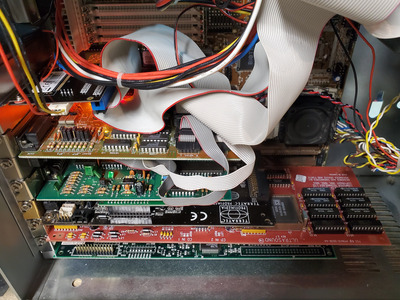

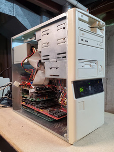

Worked on testing more sound card configs in my 486 system.
Tested out the combination of a GUS Classic, Terratec Profimedia Gold 16/96 and a Yucatan FX wavetable daughterboard, plus a Roland MPU-IPC for external MIDI.
Since the MPU-IPC has its port set to 330, I set the MIDI port on the Terratec to 300. For games with configurable General MIDI ports this was fine. I did run into an issue with X-Wing which doesn't allow for custom port settings. Though I could always use a custom batch file to change the Terratec port or just use an external MIDI module for that game.
Other than that one little wrinkle, everything else tested fine whether using GM, an external MT-32, GUS, or SB Pro compatible sounds.
Quite happy with this setup. 😁

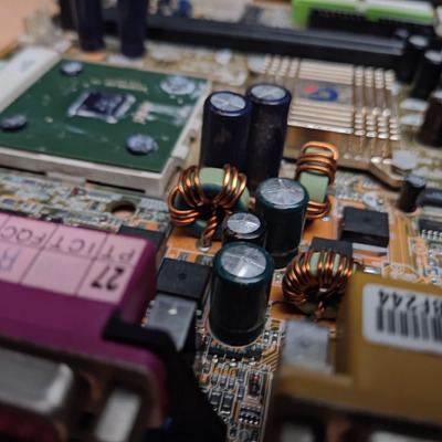

Recapped GA-7VKML... I think I will do a fun budget 2001/2002 build with a Duron
