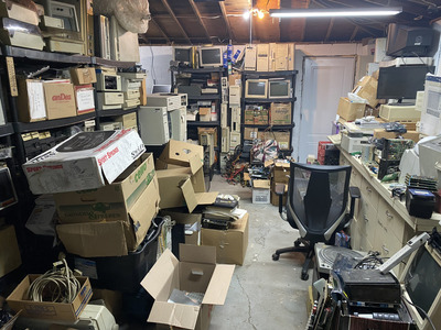

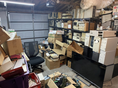

been working at slowly moving a portion of my inventory/collection/hoard/whatever one wants to call it, to the storage garage this past week

goal's to eventually get the garage holding most of the machines and larger items like power supplies, while the loose cards/laptop stuff are at my apartment. the garage currently holds about 40% of what I own by volume.
probably 2/3 of this is stuff accumulated from e-waste.

That looks like heaven to me 😀 Very nice collection you have there. Will keep you busy tinkering with old systems for quite some time.

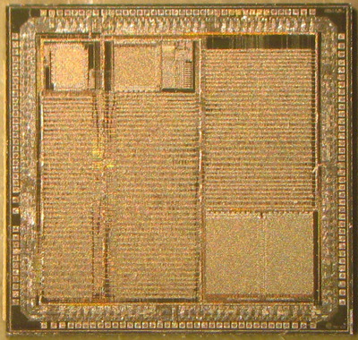

That would be fun to explore but not necessarily to own. This is like peer support in a way because my "collection" no more looks as bad as yesterday.
I've been working in totally different scale. Now planning to buy a real microscope.

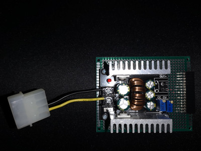

Built a Socket 7 Pentium VRM today. It uses some prototype board, a 15+15 RA connector and a Chinese special '20A' Buck Converter. I think 20A is wildly optimistic, but it should be find for what the motherboard (GA-586ATM/P 66Mhz FSB) can handle. Had to go with a 12V input as the chip/circuit they used on the buck converter gets a little weird if the Input/Output differential is too small.
Early testing is good, computer boots and is stable. Longer testing is required though to see how it performs with other CPUs. End goal I suppose is to get a K6-2 running in this board, 2.0/6.0 multi at 66 FSB.
If nothing else it keeps me busy 😁

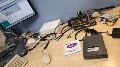

Got this!
External SCSI SyQuest 230MB 3.5" drive. Full set, will archive the floppies unless they are already archived.
For whatever reason, it also seems to include coincidentally 230MB MO disk. I have an internal 650MB MO drive - i wonder, if it would work with that?
At last i got to it to check if it actually works as i had the bench computer with SCSI controller up and running... and it does!
My first experience with "removable hdd platter storage medium"! 😁 It even sounds like an HDD!
I have one disk and it seems to be okay.

haha yeah I have enough stuff to last about three or more years full time at this point, but it's grown to a degree where it's entering "hoarders" TV show range, so I am more cautious about buying large lots of stuff now.

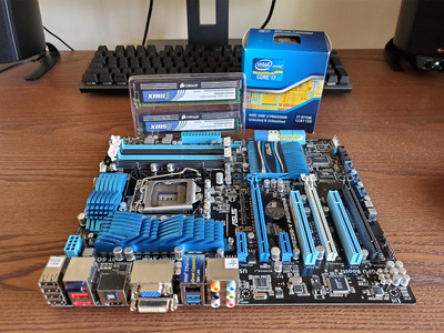

Upgraded my 'Ultimate' Windows XP build with this Asus P8Z68-V Pro/Gen 3 motherboard, i7-3770k CPU, and 2x2GB DDR3 RAM.
Based on the performance gains so far, I'm finally making better use of the 980 Ti I have installed in this machine. 😁

Further testing, I've had both a K6-2 and K6-3 running in this board now, thanks to the VRM. (6 x 66Mhz / 400Mhz, using a 2x multi on the board), with the K6-3 being the better performer.
The BIOS for the board has absolutely no clue what the CPU is (to be expected) and amusingly reports the CPU to be a 486DX2-66 😁 so the K6 Dos tools/drivers may help me eek a little more performance still.
Quite pleased considering I started with a Pentium 100 on this board, then a Pentium MMX overdrive @ 200Mhz and now with the new VRM a K6-3 @ 400Mhz.

Good stuff!
