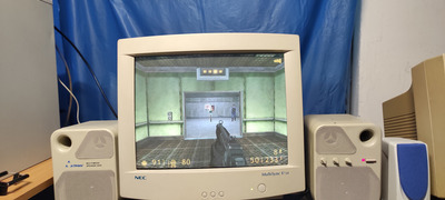

Finally got a working CRT monitor for my Pentium II PC 😁

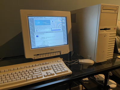

Over the past week and a half I have been getting my Umax SuperMac C600 up and running, and I’m happy I did.
The attachment 826BE87F-1909-4DAB-BED4-213EA51CD48D.jpeg is no longer available
Now if only 5v 168-pin EDO wasn’t dumb expensive.
Reply 23287 of 29860, by Thermalwrong
Nice setup, seems odd to see Mac OS on a Dell (monitor) 😀 It looks like the case may have been made by the same manufacturer as Dell's ATX systems from that era, lotsa plastic but really nicely made.

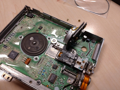

I've got this Thinkpad 240 laptop that I put back together from all the remaining parts and got it running with some repairs. But there are some parts missing, so far I've made the hinge covers just measuring some real ones and those fit really well - my FDM printer and PETG filament are letting things down and I may have to try out resin at this rate. But something I've not been able to make by eye is the hard drive caddy / cover. These are super rare for the Thinkpad 240 series now, since well, it's a special caddy connector for a 23 year old laptop.

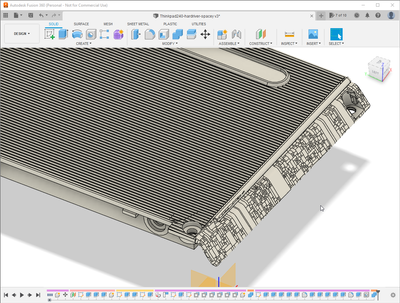

Using my 3d scanner I've been able to copy the one I do have that isn't spare for this particular Thinkpad 240 - I have a 240, 240X and 240Z, only 2 full caddies with covers and they've got parts broken like the plastic mounting tabs. Now this full cover in CAD means I can print out more as needed. The test print fit beautifully and looks good for an FDM 3d print, it's really quite big in 3d print world but only a 2.5" drive.
This one was especially neat because the complex curve part just remains as a 3d scan while the flat part is all CAD shapes so they can be modified easily.
Now that I've got a working design, I can modify it to fit new stuff! So far here's my design to fit an mSATA SSD where the big old hard drive went:
The attachment hddcaddy1.png is no longer available
The attachment hddcaddy2.png is no longer available
I think another good one to have would be the compact flash to 50 pin adapter

Man, I love CRTs. Great space heaters in the harsh winters, beautiful black levels, crisp picture, and sharper than flat panel displays/TV sets. If I could get my PVM-1341's digital RGB working (possible misconfiguration inside for the intensity drive), I'll connect my systems that use CGA or EGA to the set in no time.

those speakers take me right back, I can hear need for speed wheel spin sound just looking at them 😀

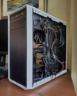

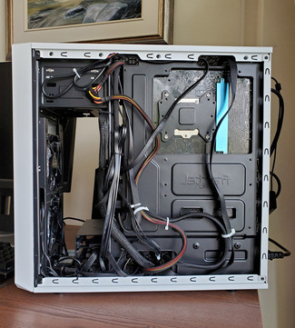

Did some cable management my XP machine following its upgrade, while reminding myself how much I do not enjoy cable management.
You and me both. My Xp rig needs some serious cable management and I'm not well gifted in that area.
