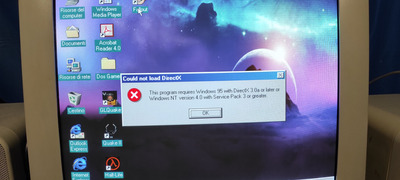

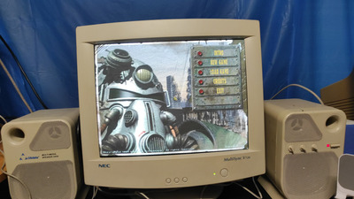

Yesterday I downloaded Fallout 1 from the Epic Games store.
Tested it on my Pentium II build: it works!
The attachment IMG-20221223-WA0011.jpeg is no longer available
The strange thing is: it starts only after opening the dxdiag menu 🤔
Before, it gives me this DirectX error:
The attachment IMG_20221223_233302.jpg is no longer available

I'd reinstall Direct X, and try various versions, actually I'd just do the final DX9 unless that doesnt fix it.
Reply 23382 of 29869, by DosFreak
It's likely the Epic ver of Fallout is using the sfall ddraw.dll which is incompatible with 9x. Try deleting or renaming it if you want vanilla Fallout to work on 9x.
AFAIK, the lowest supported OS by sfall is Windows 2000 and XP+ are the versions the sfall dev supports.
I'm thinking this usage comes from these versions of the game being orginal Fallout patched to latest official version with the High Resolution patch installed but I haven't looked at the Epic version.
Thinking for 9x likely the TeamX patches may be the best bet for original fallout.

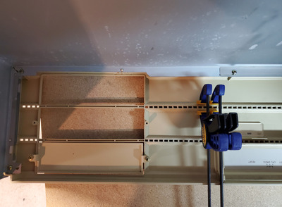

Discovered my Epson Equity III+'s front cover had cracked. Not sure how it happened, but all those little plastic struts had split apart.
Applied some acetone and clamps and hopefully that will seal it back together.

Renaming ddraw.dll did the trick!
Thanks a lot 🍻

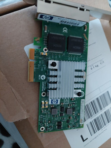

My new retro network build network. It serves something else too but 4 vlans, one for retro and other for various iot's and the rest for my home network. Nothing fansy but working. Pfsense and 4 gigabit ethernet ports. Works with everything for my retro nas serving drivers and os's, games 😀
