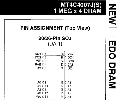

Following watching this video, I just converted 2x sticks 72-pin 4MB EDO memory into FPM: 386 with EDO memory - by Bits und Bolts on Youtube
Essentially, EDO can often be made to operate as FPM on a per-SIMM basis by connecting the !OE pin of each memory chip to !CAS. Normally those are connected to Ground which makes this mod a little tricky since there's not usually an easily accessible trace that you could cut for the !OE pin - here's the pinout of the MT4C4007JDJ chip I'm working with for reference:
The attachment edo-to-fpm-4.png is no longer available

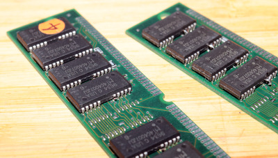

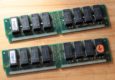

It requires sticks with 20-pin SoJ chips that are spaced fairly far apart and I tried two methods, one was heating the pin while pulling it out using some sharp tweezers as a pick. This was tricky but it worked for the first module. Once the pin is lifted from the Ground pad, bridge it to the adjacent !CAS pin.
The attachment edo-to-fpm-1.jpg is no longer available
The attachment edo-to-fpm-2.jpg is no longer available

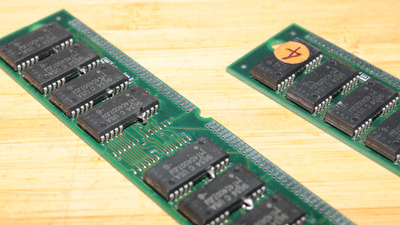

The second method I tried is almost better and much quicker, but I ended up with one cut pin ending up underneath the chip and I had to refit it with hot air after cleaning that up. Anyway, this method is to use a sharp knife to cut that pin at a 45 degree angle by rocking the knife back and forth until it's through and hits the plastic. Push the solder side of the cut pin down a little bit to make space, then solder the cut !OE pin to the !CAS pin.
The attachment edo-to-fpm-3.jpg is no longer available
The board I'm testing with is an old MSI MS4143 which definitely does not support EDO memory, in fact if I install an unmodified EDO stick in the board, then it hangs with POST code C2. With the 2x modified sticks though, it boots and detects 8MB - time for some memtest 😀
