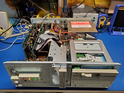

Reply 25988 of 29871, by DerBaum
DerBaum wrote on 2023-10-08, 21:53:
Today was a mixed bag of retro computing... […]
Thanks to vogons user @Balog i now have a second FastRAM Card and a 287 co-processor for my ast premium 286.
First good news:
The 287 co-processor works perfectly fine.
I removed the "jumper" co-processor and installed the new one. That was simple.
The FastRAM card itself works. It detects the 512k ram and works.
Now the Problem:
If i install both fast ram cards only one card works. You can set the switches for first/second card and give each one an address.
Each card for itself works (mine with 1MB and the other one with 512k). But i cant get the to work together.
My theory is that the first card has to be fully populated before the second card is used. But i have not enough memory chips (missing at least 36 chips to test this theory)...
At least i know the second card works.
Now the really bad news.
I think i have killed the 5 1/4 floppy drive.
While i was tinkering with the computer i wanted to boot from a 3 1/2 floppy.
I connected the floppy drive to the system but i reversed the data cable.
I noticed the drive lights are both on and turned off the computer.
I turned around the data cable and started again.
From that moment i can not get the 5 1/4 drive to read disks.
The drive seeks normal on bootup, and when i want to read from it it starts to spin , drops the head and after 5-10 seconds i get a general reading error.
Does somebody have an idea what could be blown? here are some pictures of the drive.
Sometimes i have the feeling i am a little bit stupid.
Today i tried to install my newly repaired second floppy drive into this machine.
But i tried the original drive one last time before i put the frames on the new drive...
And it works.
No seriously. It just works.
And i think i know why...
When i reversed the data cable my boot disk was in the drive, and i think reversing the cable somehow activated the write operation and that corrupted the boot sector of my diskette...
And here is the stupid part : I never tried another properly formatted disk. And when i tried a disk it was a DD 360k disk wich i didnt notice and tried to format it to 1,2mb.
Now i have 2 fully working TEAC diskette drives. Thats ok for me too...
Just took me 6 Weeks to figure that out 😁

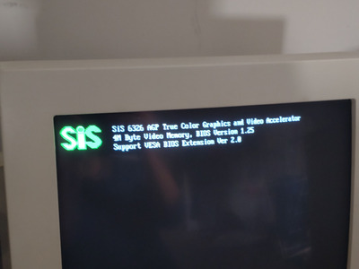

Started up the (re)installation of my Digital Venturis 575 just around midnight - but the part where Windows 98 copy files during the installation ware ridiculously slow, so I ended up going to bed...
Typed in the username and serial key this morning and at the next restart I turned the computer off to go to work. Tonight I will continue the installation - especially if I find my box where I have my CD with drivers...
Last night I was about to throw out my Compaq Deskpro 590 from the balcony.... I am beginning to consider to just stop that project forever.
So many computers, so little time...

Apart from having made nice labels for the disks that were going to help me out....
The attachment IMG_20231122_190909.jpg is no longer available
I came to the conclusion that I do not want to waste anymore time in the old summerhouse Compaq DeskPro 590.
Added a Compact Flash card to get the 8 GB drive and a little more speed but after setting it up with the Setup disk I first of all get a 1782 Disk Controller Failure. Then after making sure that the cable was seated correctly I get a 1790 Drive 0 Size error - which is probably due to the amount of sectors on the flash card is too high for the BIOS (or the wmic command in Vista simply give me the wrong data).
I then decided against my original plan to take the 850 MB drive from my Venture 575 to install that one and set it up instead. That one I have the correct data from the Phoenix BIOS.
With this one there was no error messages and it loads into the Diagnostics disk I've inserted. However this require a reboot, and I've noticed that this computer really do not like to be rebooted as it will hang in there last screen shown - in this case a blank grey one while I hear the usual boot beeps (this time I can hear errors).
So no; I am done with it. I think I will take the soundcard out and use that one in the Venturis instead of the SoundBlaster PCI card to be able to install a PCI USB card and I might also see if I can make the GF4 PCI card work in the Venturis - mainly just to lower my loss on parts bought.
The main issue seems to be that I can do something - as long as I run the Compaq Setup utility at every boot because it somehow don't want to save the configuration although the 3 MB partition seems to be made. If I skip this step I don't have access to the hard drive - but as soon as I enter the Setup with my Setup disk, I can see that it is written to be correct. So I no longer can be bothered; despite reading various guides, forum posts and watched videos I can't seem to make it work.
While fighting with this I had my grandfather's old Amitech laptop doing an installation of Windows 2000: it is originally delivered with Windows XP although it only had 256 MB RAM (if I remember correctly) and has a sticker on stating that it is Designed for Windows 2000 Professional and Windows Me - and honestly even with a fresh installed Windows XP it was really slow. I've installed an mSATA drive instead of the original 2.5" IDE (which have kept - it also has the XP recovery sector of I want to convert the drive someday) and installed 2K - also to help me out making some of the Rompaq disks for the DeskPro to get that one running. I still need to install a bunch of the drivers, including the driver for the SiS 630 graphics chip.
The Venturis is also installed with 98 SE and just need the driver works as well.
