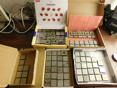

Reply 7826 of 29869, by Skyscraper
I gathered some CPUs I will need for testing and benching a non Intel chipset s478 platform.
These are my supposedly tested and sorted Socket 478 Pentium 4 CPUs... It turns out they are not that well sorted so it took a while. Pictured are 127 CPUs, I probably have just as many untested and unsorted s478 CPUs littering about.
The attachment Some socket 478 Pentium 4 CPUs.JPG is no longer available
