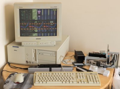

Had some leftoeuvre parts lying around and cobbled this together. Not exactly sure what to do with it.
https://imgur.com/a/Cg3QY
Another case swap project involving the reuse of a late-90s Dell case for a Prescott P4 spare parts build? I like it. Your case swap projects always amaze me, it could probably be useful for testing parts since you never know what (semi-)modern parts you might run into without knowing whether or not they work.
BTW, you have the same processor that I have in my Dell Optiplex GX520.
Thanks! It has IDE, SATA, PCI, and PCIe so it could be handy for testing a variety of hardware and drives.

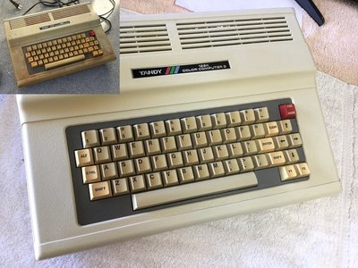

Got a Coco 3 clean inside and out. Works like new.
The attachment coco3clean.jpg is no longer available

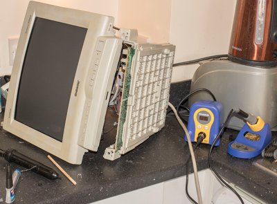

Found the 15" version of my old Trinitron monitor to play old low res games on - I forgot how heavy these things are though 😵
Our family computer used to have the 17" version of this monitor, the CPD-200ES, but I didn't want such a large display for this setup.
I don't have a car right now so I had to carry it back on a hand cart via train & bus - sadly I got it home to find it turns on but I can't set up the geometry, because it got bumped during the trip and its front buttons were damaged.

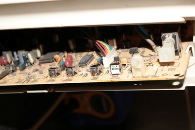

I've never had to look at the inside of a CRT before, but thankfully the PCB came out fairly easily so I could resolder the broken button and fix the two pushed in ones:
The attachment IMG_7718-2018032512 (Large).jpg is no longer available
Here it is with the replacement button, before I noticed that two more buttons were pushed in:
The attachment IMG_7717 (Large).JPG is no longer available
It's all working now 😊

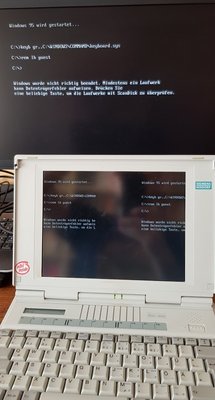

Disassembled and reassembled newly bought Siemens-Nixdorf PCD-4ND. Bad news - couldn't repair the LCD. I suspect it is a trivial thing, but nothing obvious like cables or connectors. Good news - it's a nice machine, compartmentalised and well designed. BIOS allows for enforcing LCD+CRT combo at all time, so it might become a very compact 486 desktop ("halftop", as someone called it) after dismantling upper body part. And yes, you were right, the hard drive is obnoxiously loud, so I will replace it with CF, like I do with most of my machines.
Should you hook up a CRT to the laptop in the near future, would you check whether Win95 allows you to switch refresh rates for the monitor?
My PCD wouldn't allow me to, even when I changed the monitor to "Standard VGA" with different resolutions (this solved the issue on my Toshiba laptops). The driver for the graphics chips seems to be the most recent, but maybe I'm mistaken, since it's just a standard one (Westen Digital 1MB) that came with Windows.

henryVK wrote:
Should you hook up a CRT to the laptop in the near future, would you check whether Win95 allows you to switch refresh rates for the monitor?y
I will check it if I find a CRT monitor - I don't have any VGA-capable CRT with me (one CGA/EGA CRT and that's all).

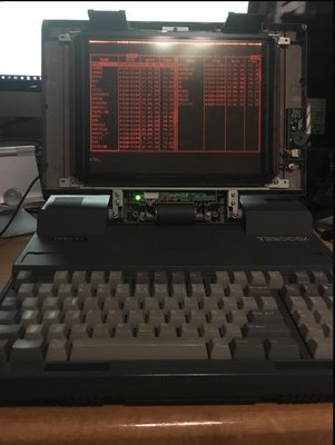

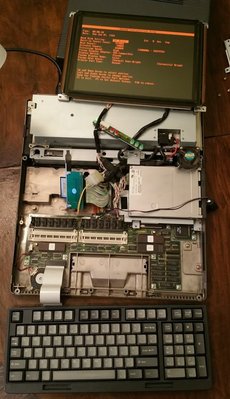

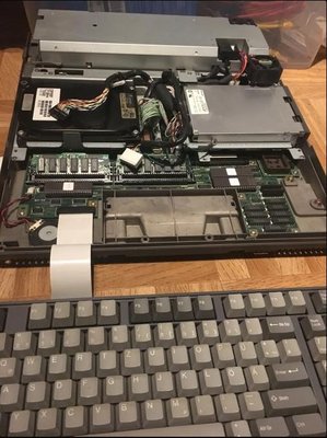

I continued today merging the parts of two broken Toshiba T3200SX from ebay into one working machine. One has a perfectly working HDD and FDD and the other one has a XT-CF, a working screen and 8mb memory, also a better conserved case but damaged internal connectors. Since I am relatively inexperienced with retro-modding or repairing, a lot of issues give me a hard time.
Currently trying to get the original Internal Conner HDD working together with a XT-CF-Lite v4.1 that can also have a bootable medium attached... so far only one works and the other one has so be disabled (HDD or CF) and that way I an not able to backup the drive. It looks like Xtide(on the XT-CF-Lite) can find the onboard controller and the CF controller, but I can not get it to find the original HDD on the primary controller on bootup or the two disks block each other or... I have no clue.
So I will be trying to read a lot about this and maybe do some try&error with the addresses in Xtide. >_<

Hey Chozilla,
Welcome to Vogons!

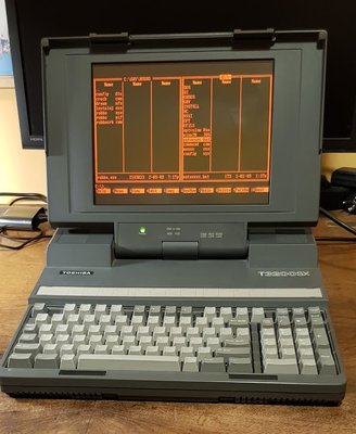

On your T3200SX - lovely computer that is. I have been down the same route (see the image):
The attachment T3200SX.jpg is no longer available
Instead of XT-IDE you can update BIOS and use CF card directly (without upgrade if you are lucky with your BIOS revision). Users JaZz_KCS and IanB have extensively tested and written about T3200SX and T5200 - you can find the two threads here:
Toshiba T3200SX BIOS? (T3200SX)
Toshiba T5200 mods and upgrades (T5200)
If you run into any trouble, ask away. You're in a good place.

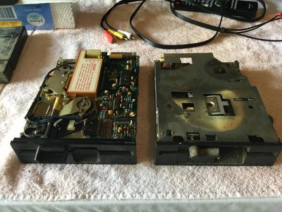

I have two black floppy drives that I recovered from an external Tandy enclosure. If they work you are welcome to one of them for this system. I believe they are 360K drives, but I will confirm on my Socket 370 workbench system once I get them cleaned up. Just PM me if you are interested.
The attachment siblings.jpg is no longer available
