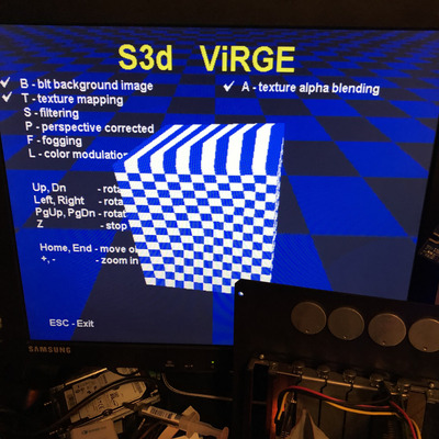

I put together a machine for testing my old 3D PCI cards and some SDK stuff with them, because my Dolch is having issues. Just a dual Abit BP6 board I had. Dual is wasted for its current use but I installed it into a motherboard tray that makes it handy. Found out that with the S3D SDK for ViRGE, perspective corrected texture mapping is optional. Explains part of why S3D Descent looks like crap.

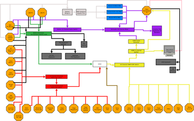

Redid the AV connections of my home office after acquiring a HDMI capture card (Magewell Pro Capture HDMI) so that I can do AV captures of any of the systems that are currently connected:
91.8 KiB
1075 views
Green = VGA, PS/2
Red = RGB Scart
Brown = Component
Yellow = HDMI
Purple = Analogue audio
Grey = MIDI
Everything except my main workstation now ultimately outputs over HDMI (either combined video + audio, or just video with analogue audio routed back seperately), and splits to both the display and to the capture card - I can either have systems displayed via the monitor HDMI input, or switch to my workstation and use the capture card for windowed playback.
Ultimately I'll be putting some videos and audio/MIDI comparisons from the actual hardware on my website.

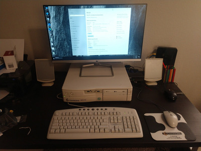

I wrapped up my Gateway 2000 Sleeper project last night. With the exception of one key component, it’s ready for day-to-day use. This low-profile case made in 1993 now houses:
- B560 Mini-ITX Motherboard
- Intel Core i7-11700 Processor
- 32GB of DDR4-3200 RAM
- 1TB NVMe SSD
- 3TB HDD
- 24x DVD-RW Drive
- 3.5” USB3/HD Audio Front Panel
- Corsair CV650 Power Supply
I provisioned space and power for a discrete graphics card (either a RTX 3060 or 3060 Ti), but I’m having a bit of trouble sourcing one right now. The Xe graphics aren’t terrible, but I won’t be playing triple-A games on this computer anytime soon.
I love having it on my desk, though. Feels like the old days (just not as noisy).

Dang, this is really impressive. Very extensive and flexible setup, love it.
I count 5 "hoops" that the output from the RGB-computers go through to reach the monitor. 😀
Personally I would add a CRT or two to the mix, but I see the appeal of having everything routed to one monitor. Oh, and with all that audio stuff, maybe some nice(r) speakers?
I'd be curious to hear how the Magewell card plays with Linux, if that's something you're planning. If I recall correctly, Linux is mentioned in the specs, but I've never heard of anyone trying it.

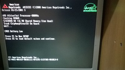

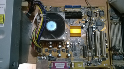

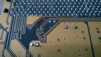

Today I dedicated myself to restoring an interrupted track on a MotherBoard M.ATX 462, I found after switching on that it is a PCChips M810LR, this abbreviation must not be misleading it has no Intel chipset, the chipset is a T- Bird aka SiS730, and the socket is therefore an SKT 462 (A).
As you will see from the image I have fixed the track by welding a wire, the result is not really great aesthetically (quite questionable), but from checks carried out before switching on it is working.
Starting the motherboard without a drive and more, I notice that by moving the RAM bank from the second bank to the first, the MotherBoard starts up, while not before (in addition to emitting various beeps), at this point I begin to see if with a second bank (i.e. with the 2 banks full) increases the amount detected by the BIOS, in fact it is so and therefore I replace the 128MB bank I had used for the test and put another 256MB one, in total now I have 512MB of RAM (- i 16MB for integrated VGA).

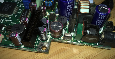

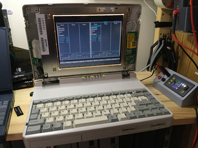

Hey, I just got a Toshiba with a bad PSU as well! 😀
Mine's a T1950CT, which was reported as shutting off when you tried to turn it on, unless you left it for a few hours. It didn't work at all for me and I didn't wait to find out.
Sure enough inside it, one of the capacitors (the 16v 1000uf Elna cap) had leaked onto the board:
971.85 KiB
867 views
Leaky capacitor evidence

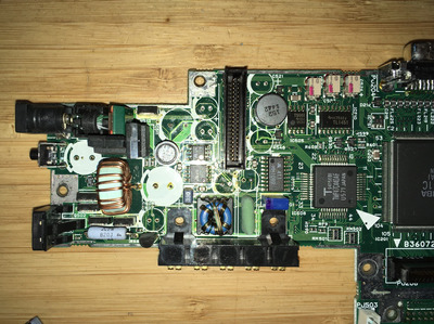

The two other big caps also smelled fishy when heated so they got replaced too. Cleaned the board up thoroughly with IPA:
1.63 MiB
867 views
Electrolyte all over the place - no eaten traces
I was lucky and had each one of these in the same capacitance, voltage & temperature rating. I only replaced those three though, the rest tested okay, were fairly small and had weird values, so I didn't want to wait for replacements.
Maybe I should make a thread about it, I made a note of the capacitors for anyone else having trouble with Toshibas of this vintage. My T4900CT will probably need the same thing done soon.

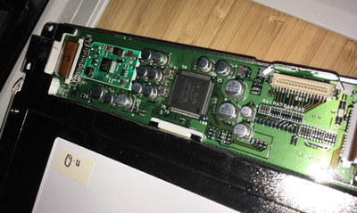

I was interested to see what the caps looked like on the display since the capacitors look like that on your one. I think this T1950CT is quite low hours actual usage since it's not yellowed, the HD still works, almost all plastics intact and the CCFL is pretty bright. Maybe it will happen in future though. Since my T4900CT clearly had a lot of usage in its day with its yellowed plastics, I Should really check the TFT in there too.
The capacitors look like they're okay for now:
858.65 KiB
867 views
No discolour capacitors here
Check out the size of the panel, 8.4" viewable area and all that board around it. While I was in there, fixed up the hinge plastics where two screw posts had snapped off, added some thermoplastic to keep it all in place:
1.06 MiB
867 views
Look at that LCD panel, huge!
Oh yeah, and I replaced the belt on the floppy drive since I don't want to go back into the laptop again - replacing those Citizen W1D laptop drive belts is the worst! The drive sounds kind of janky now, but it reads disks okay.

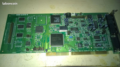

Replaced a SB AWE64 Value with this SB16 (CT2910) :
A real OPL2 and OPL3 and no background noise. It's also the sound card I had back when I was a kid.
Also, nothing to do once installed :
- No more weird / not-so-good MIDI music, because it's not a clone.
- No noise
- No driver to install (well OK I had to use the non-plug and play wizard and it asked for drivers, but I only had to point it to C:\WINDOWS\SYSTEM once)
- No TSR / diagnose needed at startup / in DOSSTART.BAT. Also Windows98SE boots so much faster ! It was so bad before that I was tempted to 'upgrade' to Windows ME... Not anymore !
- Works out of the box with anything : Cybermage, Doom 2, MechWarrior 2, Dune, Dune 2, UFO : Enemy Unknown, Lands of Lore : The Throne of Chaos, Windows 98SE, Windows XP, ...
What's not to love !! 😁

I use the Magewell card exclusively with Linux - it has a very lightweight driver that compiles with a huge range of kernels (all the way back to the 2.6.x series, IIRC), so it's far easier than, say the Blackmagic stuff, Epiphan or the ubiquitous Datapath Vision card which is otherwise recommended highly - the driver for that would not even compile on my Mint 20.x system. Anything which is only supported on specific kernel versions or (even worse) specific kernel versions on specific distributions make those cards non-starters for me.
So far I've done captures with my X68000 (which goes via the OSSC) and Dreamcast (native HDMI out via Pound HDMI convertor cable). It copes really well with both of them; resolution changes do flash up the "unsupported signal" for perhaps 0.5-1 sec, so I'm not sure it would cope with something like an Amiga or similar running a game where the display is changed after so many scanlines.
I'm playing with OBS at the moment, and the Magewell card integrates quite nicely, as it appears to the system as another V4L source.
One thing I haven't tried at the moment is HDMI digital audio capture, as I'm just doing analogue capture right now. In theory, the modern stuff should just squirt the AC3 encoded audio over the HDMI connection and it should be captured digitally by the Magewell card.
The one downside for me is that being a V4L source... when I now start up a Zoom or Teams chat with others at work, my Magewell "No signal" screen is now the default video source, rather than my webcam! 😁

Reply 18679 of 24014, by henk717
Reprogramming the chip seems to be more expensive than the board but i did find a place that would ship a brand new chip programmed with a bios of choice.
I still think it will be salvagable with a cmos reset, i had this board error out on me in the past resetting itself. I am not sure if i had the front panel hooked up but i certainly manually corrected the settings that day while this time i kept the defaults.
I am also a bit of research further, even in the bugged state you indeed get 1 (buggy) boot if you reset the cmos and choose to boot with defaults. This would be enough to flash a bios from floppy. Ny floppy's are terribly unreliable so ill settle with my floppy that can trigger a cd boot and a freshly burned disk if i end up having to go this route.
The reason this is relevant is that bios 2.19 and lower do not have this check and any bugs associated with it (i manually verified this with a tool to mod amibiosses which allowed me to dump the warning string which is present after 219) Its apparently a common thing with the board where ram timings, front panels with the 5th pin unused (which i have) or just corrupt cmos settings can trigger this. So i will definately downgrade the bios to get rid of this bug forever.
So right now my war plan is to first disconnect the front usb since i originally had no proper pinout for this so i only connected it recently and ill then see if it allows me in. If it does i can perform either a cmos restore with the utility or a bios downgrade. If it doesn't ill have to reset the cmos and immediately dive in the settings trying to configure the board properly again so i can then perform the downgrade. If that fails ill try the floppy + boot cd method (already prepared the iso). And if that fails ill order a new bios chip for $10 and request them to put 2.19 on it.
