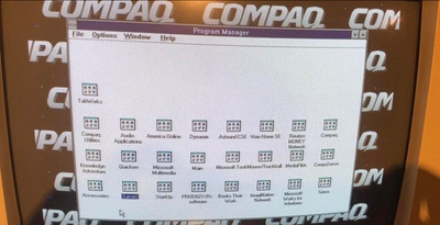

Holy shit, what a bloatware party. Just look at this:
The attachment presario2.jpg is no longer available
I will live with that crapware. It's both authentic and autistic. Also it welcomed me with the TabWorks shell - I turned this off immediately. Love this machine.
