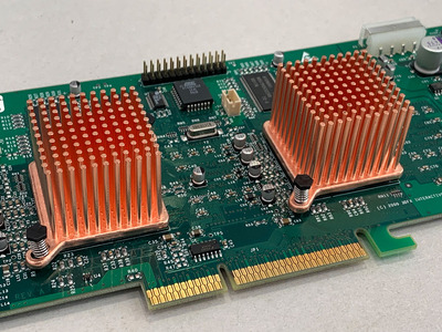

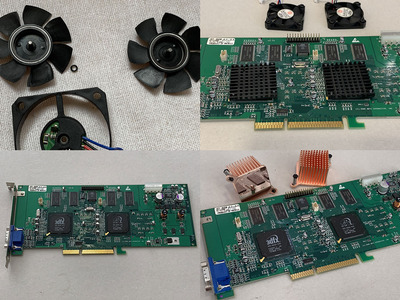

As mentioned before I had some problems with my Voodoo5 5500. One of the original fans is just too loud/noisy. I tried using silicone grease and sewing machine oil to no avail.
During the disassembly of the fans I noticed the noisy fan had a missing sealing rubber. As the original stickers were untouched I have to assume it was missing from the beginning.
Now, if I have to replace the fans I might as well do it properly.
I removed the original fans, the factory coolers, put on some Arctic Silver and fit some one inch copper coolers on top of the BGAs. The new fans have a voltage range of 7.5-13.8 VDC so I’ll solder in 47Ω resistors to have them run as slowly as possible while keeping them in spec.
Finally some aligned coolers on a Voodoo5 5500...

Holy moly where do you get heatsinks like that? And do they just mount on to the existing holes?

I got them from Amazon (Enzotech). Not really a bargain at 32EUR/piece ... then again - the Voodoo5 wasn't really cheap either and I wanted a solution with longevity.
Yes, they do mount into the existing holes (variable from 54.6mm to 59mm). The hole to hole distance of the Voodoo clocks in at approximately 57,15mm (probably 2 1/4 inch).
Right now, fans included I do sacrifice 2 PCI slots but that may be reduced to 1 PCI slot when using a 3D printed funnel to mount the fans from the side (horizontally/vertically, depending from your point of view).

Those things are already freaking rare and really expensive, so good call regardless of heatsink prices. Who knows if I'll ever get my hands on one of these... I have a Voodoo 3 to which I've attached an old intel stock pga478 fan to keep it cool. It is my first (and only!) working 3DFX card, so I've got to keep it functional. You might want to check the capacitors on your card in the near future, though.

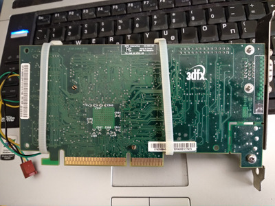

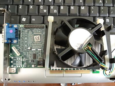

Reply 15632 of 19589, by TechieDude
RetroLizard wrote on 2020-05-30, 12:52:
How does one put a fan on the heatsink of a video card that has nothing for screws to go into?
With zip ties, of course:
1.13 MiB
463 views
1.36 MiB
463 views
It doesn't exactly look professional, but it works, and it looks better from up close 😁
derSammler wrote on 2020-05-30, 12:54:
The screws go between the fins, just like with most heat sinks.
The fins are too far from each other for screws, and I would rather not try to drill into the heatsink. Zip ties on the other hand, are perfectly reversible 😉

Zip ties personally just frustrate me 🤣. Maybe I could put a different heatsink on the card? (Also have a Voodoo 3 1000 card with no heatsink or fan)
Reply 15634 of 19589, by TechieDude
RetroLizard wrote on 2020-05-30, 13:17:
I don't like them either for cable management, but for non-destructive cooling mods they're just fine. As for putting a different heatsink, I can't recommend that because the heatsink is glued to the chip and you may or may not kill it, unless you know exactly how to do it with no issues. You should be able to install one on the Voodoo 3 1000. Do you mind posting a picture and the specs of it?
