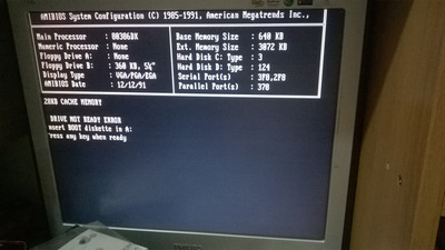

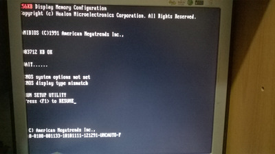

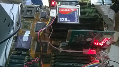

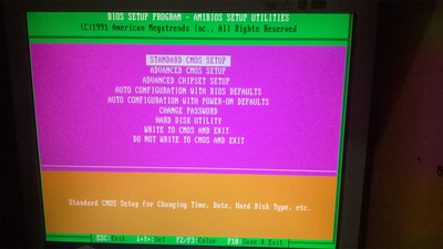

Fixed 386DX motherboard, fixed keyboard controller problem.
After various assumptions about broken tracks or shorted or broken components, I simply removed the keyboard controller chip and cleaned the PINs with very fine glass paper, they were visually like new when finished.
Starting the PC you hear several tac tocks and two beeps, a sign that the PC has woken up, on the screen I have the main BIOS screen.
Entering the BIOS the values ​​are the default ones, you have to set those to be stored and find those for the 128MB CF-IDE (which I use as HD).
From the bottom line of the BIOS splash screen, I should go back to the motherboard manufacturer and perhaps the model, this can be useful in the future to set the jumpers correctly (adding something).
As soon as I can find the numbers of cylinder heads and faces, I will be able to start the installation of the OS and Windows 3.X.
As soon as possible I order a 387 coprocessor, I should choose one between the ULSI and the IIT because both are available at 40MHz, unlike the Intel one which goes at 33MHz (asynchronous).

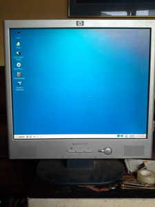

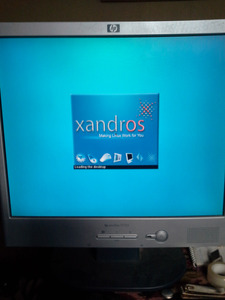

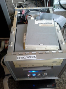

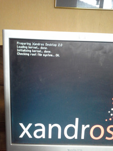

My the Shuttle XPC sorted and now booting to the operation system desktop. The old hdd was doing the trying to load then reboot thing the in XP installation. The seller mentioned an issue with the hdd so i wasn't surprised at all. Attached a USB keyboard and mouse then replaced the cmos battery. Fitted a SATA spinning rust hdd to it, set the bios to boot from the cd drive. Fired her up with the operating system installation cd in the cd dive. 10mins and one reboot I was presented with a fully functioning desktop:
Reply 19189 of 29867, by kolderman
Caluser2000 wrote on 2021-06-14, 20:44:
Which CPU does it have? I have a P4 one. What GPU are you going to use? The classic Voodoo5 AGP?
Reply 19190 of 29867, by Caluser2000
P4. HT. I'll use what is in it for the time being. but I have around 8 APG cards iI can put in it. But in saying that speed of the system and OS from the same year are faaaarst.
Now that I the hardware is honcky dorry I'll give the system a good dust out and install a more current 32-bit Linux distro.
I seem to have come the sanctuary for wayward P4s. And I am certainly happy with Celerys based around them 😉 They both are very stable platforms.

Why Xandros? I prefer Puppy or AntiX myself just curious.
Reply 19194 of 29867, by Caluser2000
appiah4 wrote on 2021-06-15, 06:14:
It's the best period correct LInux out there. Great hardware support for the time. The install size is around 500megs or smaller depending on your installation choice. It doesn't install gigs of shit you are not going to usre on a desktop system. Great period correct MS Windows network support and a ton of other reasons. I can use the Sarge achieved Repos to install more stuff. Has Nvidia video card support.......Oh and it is faaaaaast.........
Apart from my wife's laptop with MickySoft Windows 10 on it I'm using Linux Mint Debian edition 4. Loading that on the Shuttle XPC now. Modern 32-bit Linux with regular updates without having to reboot the system 98% of the time. An can still use the system while updates are being done. The installation is going to take because the Xpc only has 512megs of ram at the moment. The other stick was broken now it is broken in half 😀
