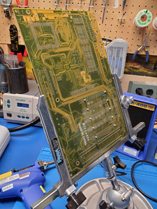

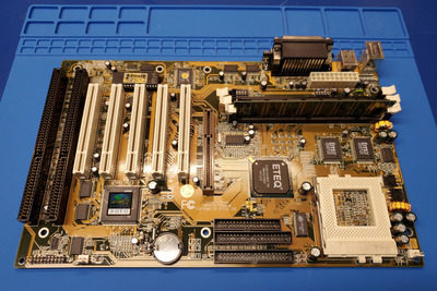

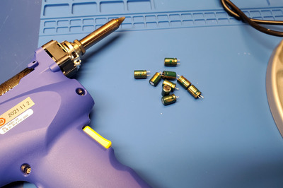

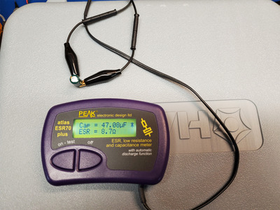

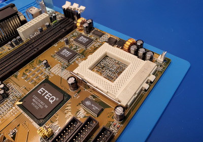

Replaced some capacitors on this SOYO SY-5EMA+ V1.0 motherboard.
In initial testing I couldn't get it to POST. One of the 1000 uF caps was budging so decided to de-solder and replace all the 1000uF caps.
After testing them it turns out only the one cap was bad. Oh well, no harm in replacing all them I suppose. At least they now match the other caps on the board. 😁
Not sure if this fixed the issue, but we'll see once I get around to testing the board again.
edited to add:
Didn't fix the problem. Still won't POST. It's getting power, fans spin and various components (including the CPU) get warm. But no POST, no beeps.
Back to the drawing board.

If I need to have something steady I have to literally tape it to my table.
Guess I'm on the cheap amateur bench. 🤣
Honestly that board holder is one of the most useful pieces of equipment I have. Makes soldering and desoldering soooo much easier. 😁

It is pretty neat. I want one now...

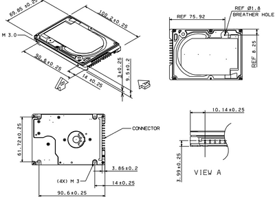

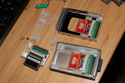

Ug, since I got the Sony Vaio laptops up and running I've been on a drive to get as many as possible up and running since I've now got a few too many. I'm running out of good hard drives.
Then I got a Toshiba 470CDT and found out the hard way that the caddy is there for a reason. I put in a hard drive just kind of eyeballing it into the port without the caddy thinking it would be okay - but the drive was shifted up a row and now that drive is stone-dead. The laptop's okay and the drive was worthless with bad sectors, but it reminded me that caddies are important.
Couldn't see a way to get the hard drive swapped to a CF card since the caddy is required to push the IDE pins into the connector. So today I've been designing up various CF to 2.5" form factor adapters using an IBM hard drive datasheet as a reference.
The attachment djsa-220-dimensions.png is no longer available
It fits in really well to the 470CDT, I'll probably share the design soon so anyone can print them as needed. It works a lot better than foam tape:
The attachment CF Adapter Adapters.JPG is no longer available
I wanted one that's 8mm so it can fit the Libretto as well since it's hard to use CF cards in those too, then went and made a few more types refining the design each time. The little half length one seems to fit well, a couple of little minor mistakes but good enough.
Now I want one that fits mSATA and the little SD to IDE adapter.

DIY top quality!
