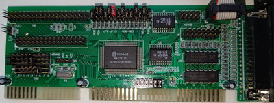

So few weeks ago decided start building 486 with VLB since this MB popped up on local auction site. Back in days 486 DX2 was my first PC MB bought for my own money. I did not have VLB version though. Also chipset called Hint Made In Japan was intriguing as well.
I hade to buy all components around 486 system. As you can see on the pic AT keyboard adapter is very sketchy. With 20EUR MB price I was hoping to keep it budget build. While CPU, Memory, IO card is relatively cheap I was surprised by ISA VGA card prices. Actually that CL-GD5428 was the cheapest card in my region. Seller accepted my 32EUR offer. It was advertised as working so all good. Today CPU arrived and to my surprise it posted. MB was sold as is.
Unfortunately I could not find manual for IO card. It might be actually thud since even floppy drive did not work.

pan069 wrote on 2023-09-21, 21:38:
vutt wrote on 2023-09-21, 18:21:
I had a quick scan through here but couldn't find it, I might not have looked close enough so it might be worth having another scan.
https://www.arvutimuuseum.ee/th99/c/c16ide_i.htm
No match on that page...
However after I posted I went and tested card (LPT port) which seemed to be configured and it worked. So card is working. Then spend entire late night searching internet and finally manually probing deferent jumper combinations. No luck.
Then while already bed 1AM while surfing for last time found ebay sale by searching Winbond chip ID i think and found that pic (attached). Had to get up and verify in the middle of night... ...bingo, it worked. So now I'm rocking PicoGUS in 486 and having good life!!
I'm putting here for web crawlers card exact id: "SIO-WB83787-3" So future retro generations can find this pic with jumpers setup - IDE, FDD, Com-s, LPT, game ports should work with this combination.

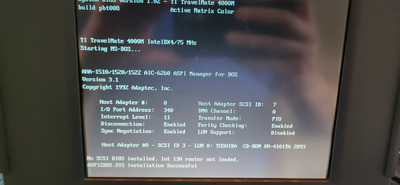

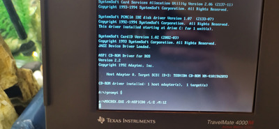

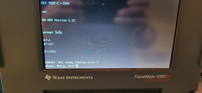

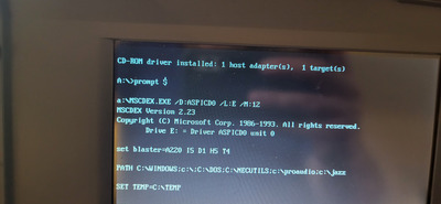

Today I tried and failed to set up a Toshiba SCSI CD Rom which is within a Texas Travelmate 4000m Dock.
I downloaded the SCSI Driver Disk which added lines to my autoexec bat and config sys.
All seems good when booting.
There is no guarantee the CD Rom actually works!!
When I insert a CD the light stays on constantly.
Would you agree the drive or dock are faulty?
The speakers and amplifier in the dock work.
Ta
Louis
