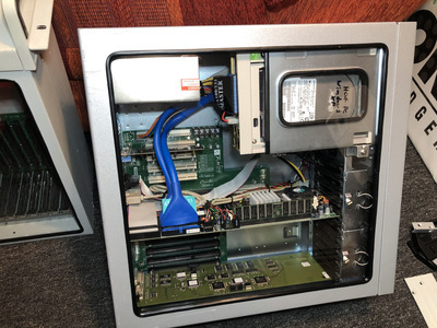

At the moment i reroute the cables, do some small fixes and make it look nice from the inside.

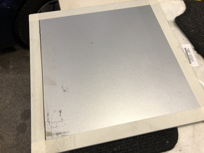

Window 2 done... Same procedure as the first one.
Before:
1.86 MiB
1523 views
I had to remove a bent metal corner from the drive cage because it was touching the original side panel and with the new window it was a little bit tight. I used the same rubber stuff to make the drive cage look a little bit better.
It was the same like on the right side just pointing upwards...
1.09 MiB
1523 views
1.99 MiB
1523 views
Cable management took a day but looks quite tidy for an old industrial system i think.
I even managed to hide all the power cables in a unused drive bay.
I replaced the IDE cables with fancy ones that also look really nice.
To give this system some Sound i installed a Soundblaster 5.1 VX i had in a corner.
I removed a 4xSerial card and a CAN Bus controller from the system, but i left a huge DSP card in it just because it looks neat. I dont even have drivers for this card and cant find any information about it.

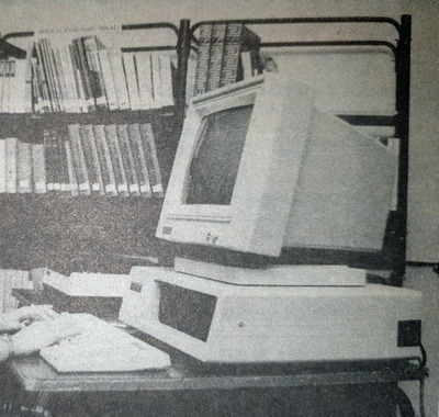

Below, some example of microcomputers developed in Cuba in the 80s:
LTEL-24: circa '84-'85, IBM PC XT compatible, 8088, 640kb of RAM expandable, 2 5 1/4 floppy drives. this ones is one of a serie (18, 24, PC, ZM). A friend has a motherboard but I hope to find a complete one.

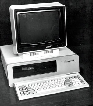

CID-1417: circa '86-'87, compatible IBM PC XT, but full 16 bits, uses an 8086 or 80186, 640kb of RAM expandable, could use 720kb floppy disks
At least both LTEL-24 & CID-1417 could be produced by replacing almost all of its chips with equivalents from Soviet/Bulgarian/Czech/Polish/etc production of the time

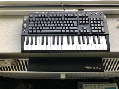

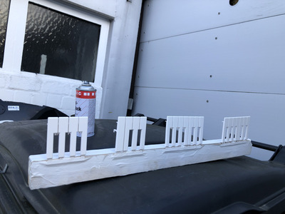

Now... How about drums? An instrument everybody loves. https://www.youtube.com/watch?v=fqM7bN3Kc7I
Step 1: Paint your drums white because they had yellowed so much not even retrobright could save them.
1.03 MiB
1428 views
Step 2: Reassemble your drums.
1.61 MiB
1428 views
This is Rock´n´Roll .

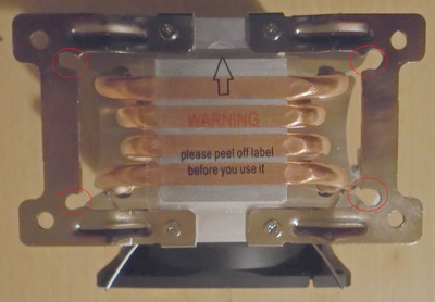

Modded the mounting brackets on a modern tower cooler to support socket 604 ( and 603 / 771) - this stuff is hard to drill, even with new bits, so 20 mins with a decent set of needle files did the trick.

For those who don't know, you need carbide, cobalt, or titanium drill bits to get through steel. And even then, it's incredibly laborious. I drilled 16 holes into the bottom of a steel case to add four wheels this way with some cobalt bits, and it was not fun. Next time I will try carbide.

Agreed, and these were the very ones I had (Bosch brand) but would still have been tough - was also worried the bit would blow out the side given the size / location of the holes (didn't want to risk the bracket twisting) so decided a little more time and effort was worth it.

Beware the nasty versions of those though, a nanometer of titanium nitride over a shitty drill bit to paint it shiny is still a shitty drill bit.

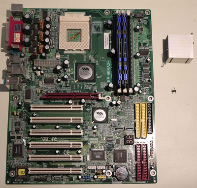

I was recently awakened by hearing a metallic noise, and I had no idea what it was - today I discovered the source. My Epox 8KRA2+ had no heatsink on the northbridge when I bought it. Luckily, I had a dead Socket 775 board that had one that was a nice fit. But the noise I heard the other night was caused by one of the retaining loops pulling out of the board, which caused the heatsink to (noisily) fall to the bottom of the case. Today I pulled the board out and soldered the loop back in place.
