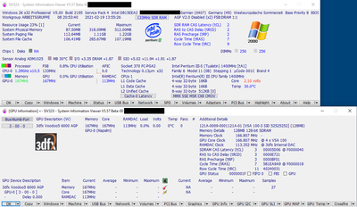

I noticed the four fans report their speed and wonder if it's possible to read this with software? If so I will update my SIV utility to do this if you can tell me where to read the speeds from.
Last time a checked SIV did OK on a 6000 and I would be interested to know if it reports your card OK.
    97.06 KiB
    2714 views

All v4 and v5 cards have gpio2 routed to fan speed sensor, take a look at vidserialparallel register in vsa100 manual. Problem is, you can read only first chip, i may be wrong thou. But on that particular card i had intention to use this gpio for an other purpose (vsa100 has only one input gpio)
Not tested your util so far, but highly likely that it’ll report my card absolutely the same way as v56.
