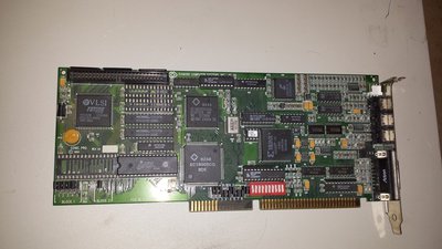

found this in a 486 I just bought. the sound card is a ISA by Diamond Computer systems sonic pro. cant find any info on it. I don't see a Yamaha FM chip but it looks to have a SCSI controller.

It's Diamond Sonic Pro (or is it Sonic Sound rev. A5?) based on Sierra Semiconductor ARIA chipset! This thing is uber rare and no photos of it are available on the net.
Please take another photo so that FCC ID is seen.
It's somewhat similar to the Prometheus ARIA16 I had:
I bet you can use Prometheus drivers if you find none for your Sonic Pro, they seem pretty generic. Many games support ARIA directly, while hardware SB emulation can be turned on for those games without direct support.
If Prometheus drivers won't fit, then you are in trouble, because ARIA cards have to be initialized by a driver in config.sys before they start working.
Anyway, you've found an exclusive soundcard and now have the honor to photo, test and describe it first.

There are many Diamond ISA sound cards, but what usually can be found is nothing special, based on ESS or Crystal designs.
I have neven seen any ARIA cards except for Prometheus ARIA16 and ARIA16SE. These seem to be most popular ARIA cards; they usually can be seen on ebay twice or thrice per year.
Wide support of ARIA cards can be explained: it is supported by popular game sound driver libraries like Miles AIL and HMI SOS.
Prometheus drivers work finely with DOS. You just run the installation software and it does everything for you.
Also, ARIA cards are supported by PX player. That means you can play MIDI and XMI files in DOS over your Diamond Sonic Pro. That is, if you find the suitable driver, because, as mentioned before, ARIA cards need initialization before they can work at all.

so many switches and jumpers on this card. I wish I found a manual tucked inside the PC to go with it. any idea about those empty sockets. I assume the two by the SCSI controller are for SRAM possibly for the SCSI controller?
I don't even see that on many dedicated SCSI cards. would that actually make the built in SCSI pretty good?
Reply 5 of 17, by bristlehog
I don't think so. The big empty socket is for another 512K ROM chip, and smaller sockets might be for SRAM (used for loading DSP code). There are similar empty sockets on Prometheus ARIA16 which has no SCSI onboard. Note that despite the same ROM size Prometheus ARIA16 is based on newer jumperless ARIA design and has newer ROM. That diminishes the chance that your card would work with Prometheus drivers.
But if the drivers won't work, you can try the third party ARIAINIT tool, let's see if it works for you.
Some I/O and IRQ info is here.
BTW, you pulled the card from a PC. Is there anything resembling ARIA drivers on hard drive? Is SOUNDCFG.SYS line present in CONFIG.SYS?

good news, it appears the aria16 drivers do work. I haven't tried the aria16 se ones but I suspect they would as well. the issues was they did need to be installed via floppy and I had to write the disks with winimage. cutting and pasting to the floppy did not work. for whatever reason the card locked up my Pentium 133 dos machine but the drivers seemed to install fine on a 66mhz 486 I have. I haven't been able to try the card with any games but as far as the sound test on the driver floppy I do get the sounds in testing so the card appears to work at least in some capacity.
the only Aria game I have on hand that natively supports the chipset is Daggerfall...unfortunately for whatever reason the only option I have when installing the drivers for I/0 address is 280 and 290 neither of these addresses are an option when setting up sound in daggerfall, highest address is 260.

For Daggerfall, you can select, say, I/O 260 and then edit the HMISET.CFG file manually. I don't know if it works, but it's worth the try.
Did you try the PX player? It should be able to work at any settings. It's default I/O for Aria is 290h. The command string is such:
px test.xmi ariaxmid
I believe there are tons of games one can force to run with Aria since there are universal AIL (ariadig.adv and ariaxmid.adv), AIL/32 (a32ardg.dll and a32arxm.dll) and DIGPAK (aria.com) drivers. Some games support it out of the box, examples are TES: Arena and The Seventh Guest.
