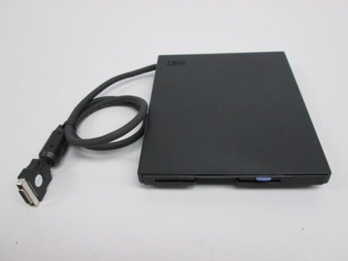

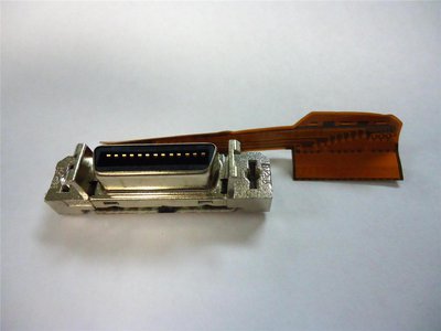

I recently acquired a fully functional external 3.5" floppy drive by IBM (produced by Sony).
I know that floppy drive was originally designed to go with an IBM laptop, but I don't have one handy.
10.14 KiB
1604 views
34 KiB
1604 views

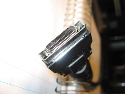

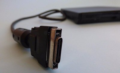

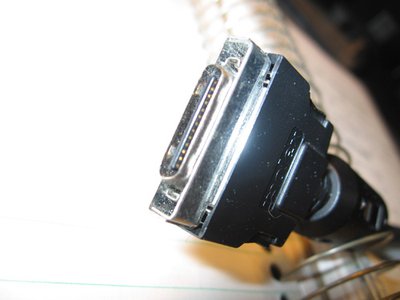

Problem is, I have no idea what that connector may be. It reminds me of a Centronics connector, but miniature.
I am counting 13 pins on each side of the central piece, for a total of a possible 26 connections.
65.53 KiB
1604 views
68.81 KiB
1604 views
Joining pictures for details. If you can help me identify that connector, let me know so I can hopefully buy an adapter for my drive. Thanks!

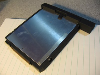

There are two main parts for this drive.
1) The shell/case which is FRU 05K6187 (or ASM 05K5907)
2) The drive itself, which is FRU 05K8874 (or ASM 20L1931)
The case has a mechanical switch that allows the drive to slide out (for repairs/replacement I guess)

Reply 3 of 15, by obobskivich
Quick searching returns this being a drive for a ThinkPad 600, which has a Wikipedia page: https://en.wikipedia.org/wiki/IBM_ThinkPad_600
The connector, thus far, appears to be "IBM external floppy drive port" - looks to be an IBM unique thing. No luck searching for adapters with the available data, and I'm not sure what you'd hope to adapt such a device to.
Reply 4 of 15, by bjt
I had one of these for my Thinkpad 240. If you open up the case you'll probably find the drive inside has a standard ribbon cable connection, might be easier to connect to that.
Reply 5 of 15, by ODwilly
My Thinkpad 770 uses the same floppy drive/connector
Reply 6 of 15, by Sutekh94
Can confirm that that connector is for a bewildering variety of IBM ThinkPads made from the mid to late 90s - my 365X (made in 1996) and 600X (2000) share this same connector.

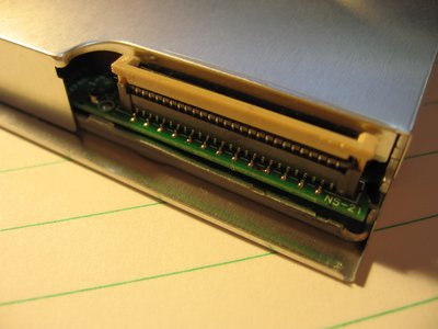

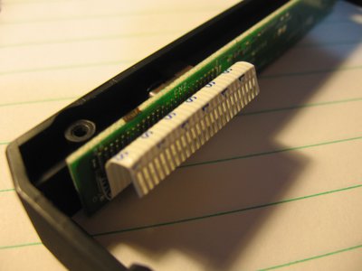

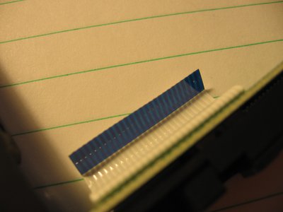

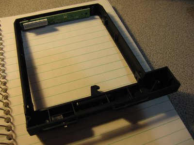

There is an external shell, and there is the drive. The two can be separated for easy repairs/replacement.
734.72 KiB
1483 views
Here is the first connector we see on the inner drive : a brown connector with 40 connectors on each side.
583.31 KiB
1483 views
But that is not really the drive's connector. The drive is still nested in this rectangular enclosure.
Separating the drive from its plastic container gave surprising results. The drive connects to its container with a short ribbon.
821.67 KiB
1483 views
There is sadly no standard floppy connector on the drive.
738.81 KiB
1483 views
Looking closer, the ribbon is one-sided. (The blue plastic covers the opposite side and is non-conductive, probably there to help straighten the ribbon)
652.76 KiB
1483 views
(continued)

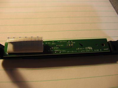

Looking closer, I count 26 connections on this.
606.77 KiB
1481 views
So here's where we are at right now :
Floppy drive (26 pins) --> Rectangular enclosure (40/80 pins) --> External enclosure and wire (13/26 pins) --> Laptop
Since there is circuitry, but no chips, I'm deducing (correct me if I'm wrong) by the lowest common denominator that only a maximum of 26 pins are "live" and serve a purpose. Maybe even less.
Also worth noting are the inscriptions on the 26->40 converter.
642.16 KiB
1481 views

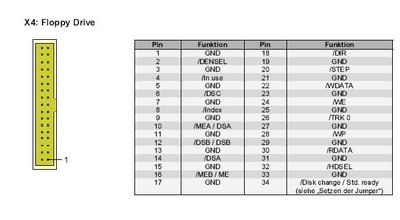

Typical floppy cables have 34 pins, 17 of them are actually ground. That means only 17 of them are left to carry data.
28.9 KiB
1481 views
I'm deducing (again, correct me if I'm wrong) that maybe some of the ground wires could be potentially combined, thus lowering the required number of wires, from 34 to 26 for a "proprietary" standard, while still retaining the standard floppy drive construction and communication logic.
And since power does not come through a separate cable, that means (If we look at the standard floppy power connector) that we lose another 4 wires. That would leave 17 for data, 4 for power, giving a total of 21; leaving 5 for grounds.
My overall guess is that I'm dealing with a standard floppy drive with a non-standard connector.
In fact with enough patience, I could probably build myself an [IBM proprietary] to [Standard Floppy] connector.
Do you think I'm headed in the right direction?

Reply 9 of 15, by 133MHz
Indeed. Someone I know did exactly that, and it worked. 😀

Reply 14 of 15, by hestermofet
Apologies for the thread necro, but hopefully this helps someone else. I found out this is a 26-pin "Very High Density Cable Interconnect" aka VHDCI connector. Apparently, IBM made an adapter to convert it to standard Centronics parallel, and they are still readily available.
http://suntekpc.com/htm-2/adapter-db25m-vh26f … ibm-08k6359.htm
There are quite a few available from this source:
https://www.alancomputech.com/ibm-08k6359-fdd … el-08k6360.html
The FRU is 08K6359 for that part, in case that source ever dries up.

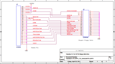

Reply 15 of 15, by weedeewee
Seems like the pinout of the 26 pin connector is available.
http://www.mattmillman.com/attaching-a-5%C2%B … attached-to-it/
