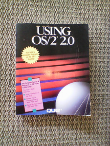

Here is some of my OS/2 stuff. I have more in a box out in the garage.
    226.82 KiB
    1043 views

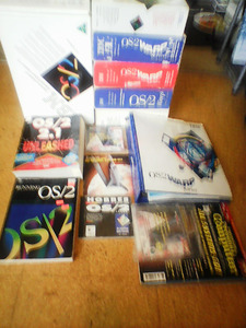

Found this in a red spine OS/2 Warp Connect box...
    363.96 KiB
    993 views

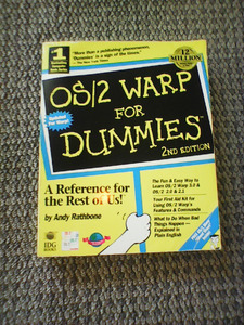

Then found this in one of my storage boxes out in the garage...
    422.85 KiB
    992 views
